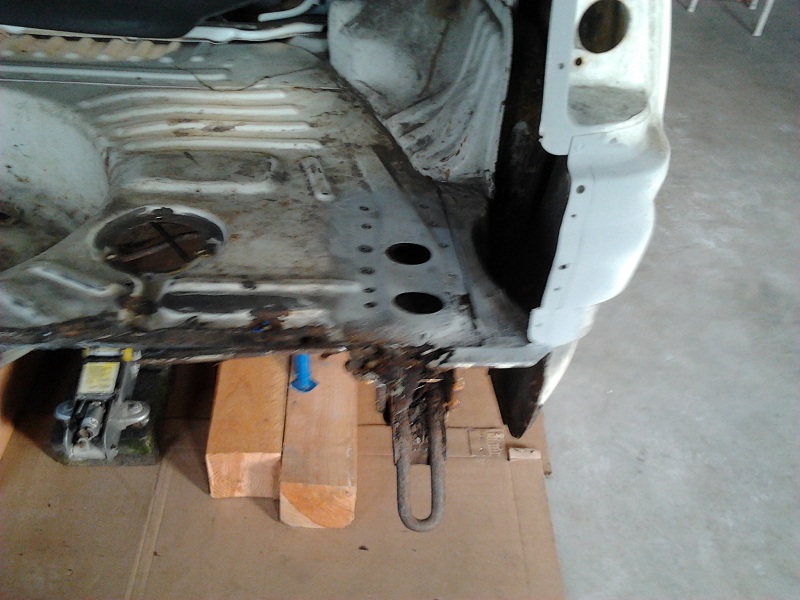

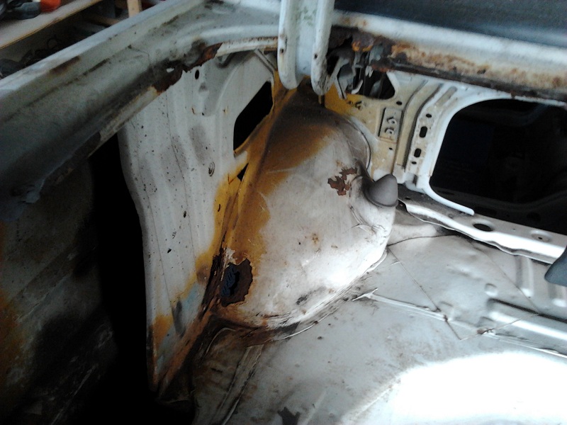

The guy had no clue what he had. Overall it's in great shape. Paint is good, minus a couple little surface spots of rust where some paint chips are, and the very top of the hatch is getting quite rusty, but I plan on changing out the hatch eventually anyway, so I'm not too concerned about that right now. It did have a fuel leak, you could smell gas real bad, turned out to be the fuel pump was leaking extremely bad. Changed that out, now I no longer smell gas. Has 110,xxx original miles on the 4A-C Everything works in it, interior was in good shape, just highly dirty. I since stripped out the interior, and tossed the carpets. They were disgusting. After a good rain, accompanied by steady 50mph winds, with gusts to 80-90, I noticed a little water pooled up where the back seats would be, and at the very back of the inside of the trunk. I have circled in the pics where I noticed the water dripping in. Probably an easy fix. I'm CRAVING a GT-S conversion. I've read up on it, and it's going to be quite involved. Basically I'll need a donor car. Once I get that, the swap over should be a breeze, hopefully. Hard part, is tracking down a donor. There's a guy here, with an '85 GT-S Coupe, he's wanting to sell it, and I'm trying my damndest to buy it off of him. It's 4A-GE needs valve guides, it smokes a bit, and something for it's idleing. It idles way high when first started. His GT-S is the perfect donor. It's a coupe for one, I don't really care to have a coupe, like the liftback way more. The interior isn't in as good of shape as mine is, and things along that line. Anyways, here's a few pics. I'd get some better shots of the vehicle itself, but the weather has been shitty all weekend and today. ![]() ![]() ![]() ![]() ![]() ![]() Here's the leaks that I've found thus far. ![]() ![]() And where it ends up. ![]() ![]() ![]() ![]() Let me know what you guys think, along with suggestions and whatever else. I'm sure I'll be needing some help come time to do the conversion. |

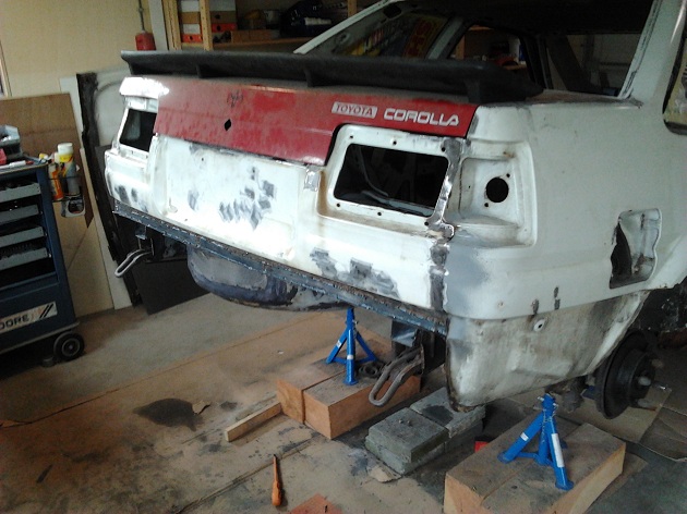

The leaks that you have circled will be caused by rust, so its a matter of removing trim around the side windows and fixing it, depending on how bad the rust is you may need to remove the side window/s, the boot leak will also be caused by rust, remove the rubber seal, you will most likely find that its rusted in more than one spot, possibly along the top down the sides, and above the tail lights and around the latch of the boot lid.

Looks like you have alittle rust repair to do but nothing major. Get that out of the way first because once these cars start to rust.... GTS conversion would be nice if you have a donor. Do note that high idling when the engine is still cold is normal for a hachi roku.Mine idles at 2000rpm and gently idles off to a comfy 800 once warmed up. Still if you're getting the engine out of the car and need to fix up the valve's anyways, it's not to much more trouble checking the rest of the engine out and making sure you get some nice fresh parts in there. In the end, a replacement engine can be found easier then a whole donor car. You need the donor mostly for all the other bits ![]() Good luck! Greetz, Bastiaan "mux213" Olij Moved down under, no more hachi ![]() |

banpei Wrote:Nice one! Oh yeah. That's why I'm trying to get that GT-S off this guy here. It runs, has everything I need to do the conversion. Those rust spots worry me, but they're seriously not that bad. I've seen WAY worse on some eight-sixes here. I'm sure it's nothing to repair since they look so minor. |
