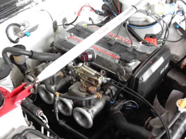

02-16-2006, 05:10 PM
CARBURATORS
This is my 4AGE running twin 40's and powered by a Ford Sierra distributer (must be from a 1300 or 1600cc pinto engine sierra) and Ignition pack
