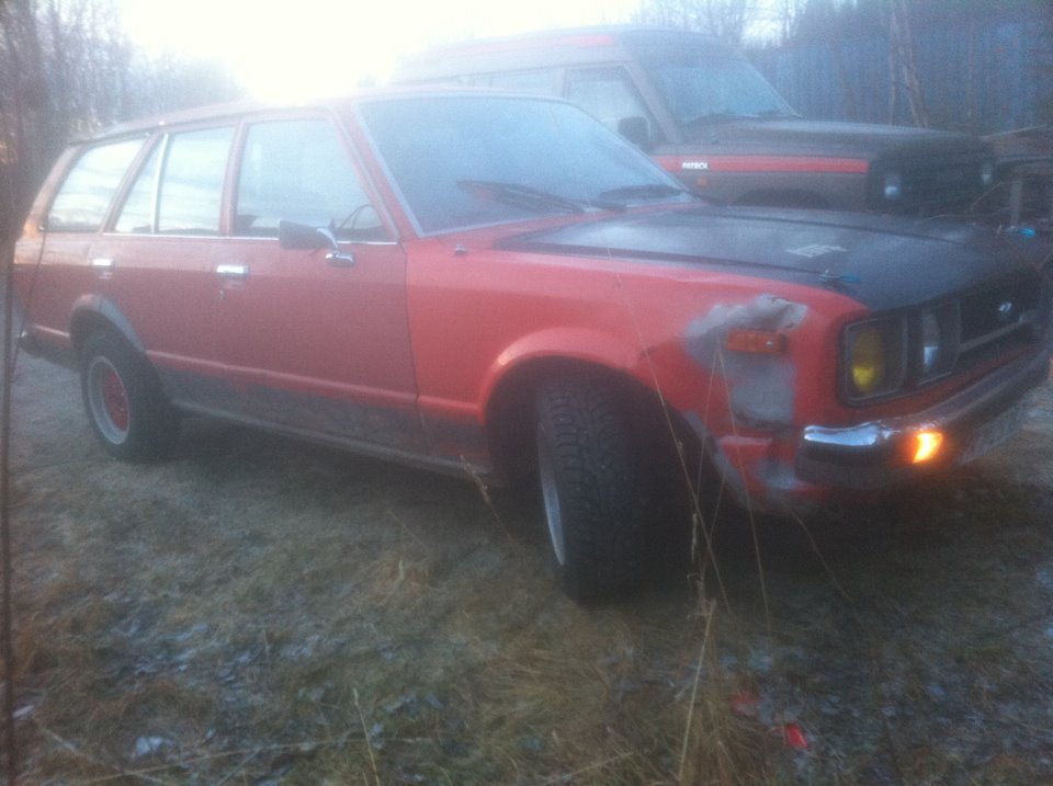

I got the wagon up and running not long after my previous update, been doing some improvements since then and just mainly driving it.
Somehow I managed to get well below 7L>100KM fuel consumption doing a mountain pass run (with pretty steep inclines), with 4 wheels in the back+lots of tools and ae86 suspension parts laying around in the car, and I wasnt even going for economy..
Recently I added some T3 AE86 steering arms and cut off the lock stoppers which, surprisingly, gave me A LOT more lock than I expected:
Since the new steering arms are pretty thick all over, whereas OEM arms are very slim, I`m starting to think that maybe shortened OEM arms could give a lot more lock than this, but until I can be assed with that+welding in new lock stoppers, I`m happy with this, its loads more than I could hope for, and winter is coming soon..
