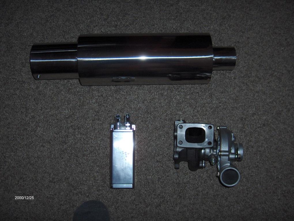

This includes:
KKK K16 Turbo with 360degrees racing bearing
Noname BOV in red
4A-G Hi-Comp, Small Port / Big Port Adapter
HKS Rep. 2½" In and 4" tip muffler

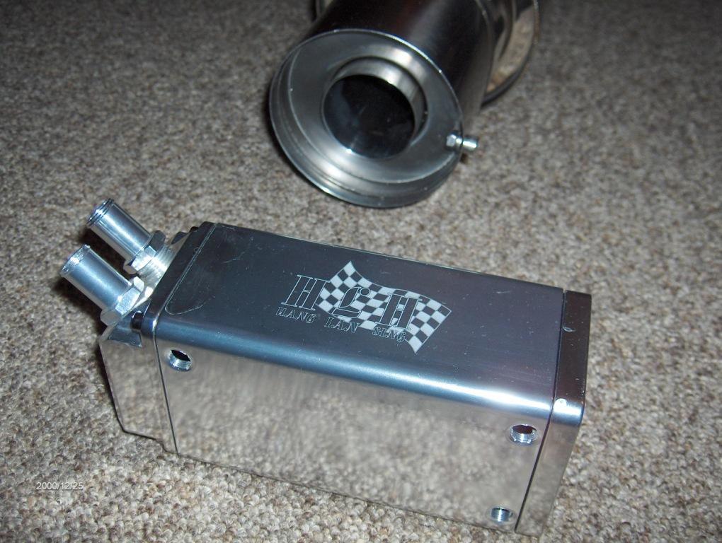

Polished oil catch tank

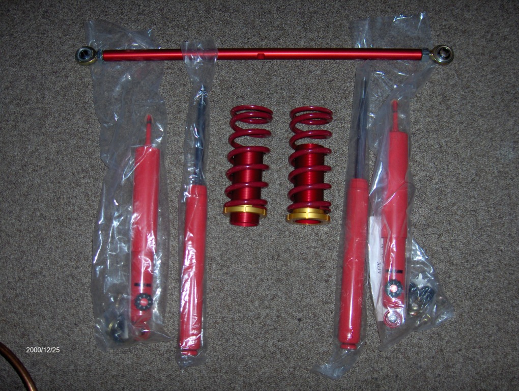

KYB AGX Adjustable Gas Shocks Front and rear for coilover kit
GC coilovers
T3 lateral rod

Ups forgot pictures of the "suspension stuff".
