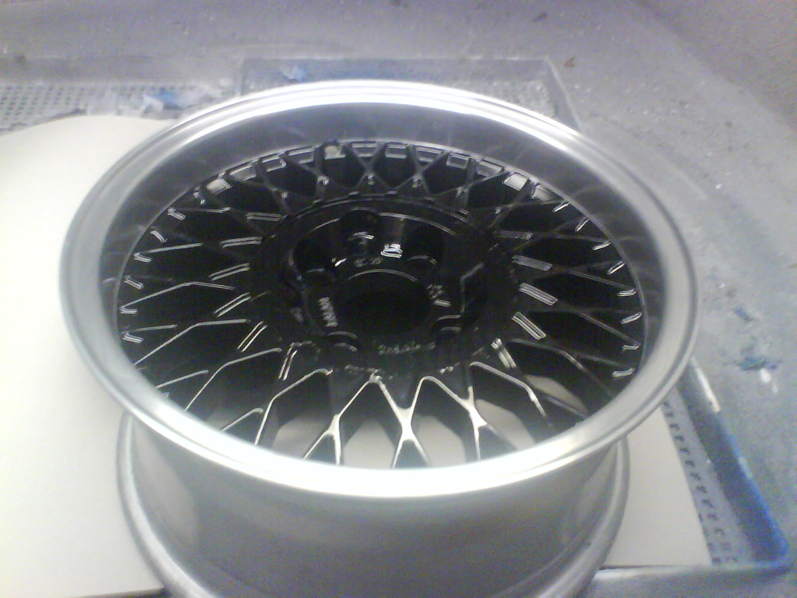

Sorry for the poor quality.. my phone usually takes good pictures, i must have messed something up.

Very nice! Thumbs up!

How did you polish the rims? Nice rims:-)

WHOW! nice job!

yeah!, black with polished lip. F*&(ing niiiice.
if you ever decide you wanna sell those rims, lemmi know...

I put it in a lathe (drejebænk) and used alot of sandpaper. Then autosol and alot of regular polishpaper. Tomorrow when the black paint is dry, im giving the rim clearcoat.

Ok cool. Witch kind of sandpaper did you use? Like "korn" 1000 or something?

First i used a 3M "paintremover thingy" on a accudrilling machine (?) to remove all the paint. Then grid 100 - 240 - 400 and final grid1000. And to polish it autosol and paper.
The result isnt shiny as a mirror, but then, it wasnt intended to be.
