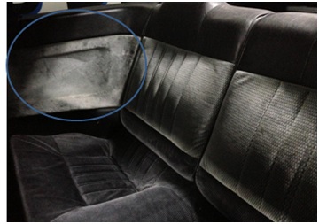

In my memory I remembered they were not the same, but could not pinpoint out why again. Must have been 8 years ago when we figured that out..
According to HR they are not equal due to the B pilar being wider for the coupe:
http://www.hachiroku.com.au/2008/11/hatc...-spectrum/
This means the section where you mount the quarter panel against the glass is differently shaped. So visually there is not much difference until you mount them.
Also the rear seats have different mount points even though they are also visually the same.
[Image: AEU86 AE86 - Quarter panel]
