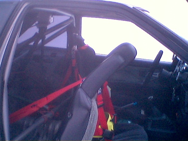

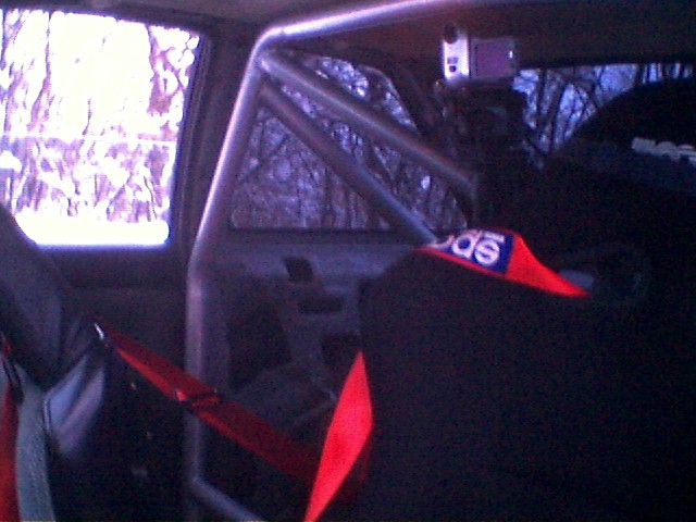

05-11-2006, 08:04 AM
Rollcage and chasis reinforcement
[Image: AEU86 AE86 - Rollcage and chasis reinforcement]

Here are few pics of my half roll cage. Central bar was copied from Zax's Heigo cage, rest is custom/DIY. I was planning to make full roll cage till winter, but.... I think to leave as it is because isn't so noticeable. Full cage - maybe race class in competition... etc.. Next step is to get homologation papers for cage and have street legal car.
