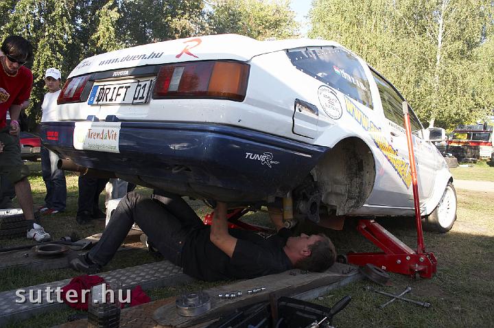

My friend has a tuned silvertop engine in his car, 178 hp and he broke about 5 zenki axles last year at driftraces. Maybe Jasper saw me at Mariapocs KOE under the car when I was changing the axle.. Smile
He changed the rear axle housing because it turned out he had 3degrees of negative camber (rally jumps.. Cool ) and now it seems like OK after 3 practise.
