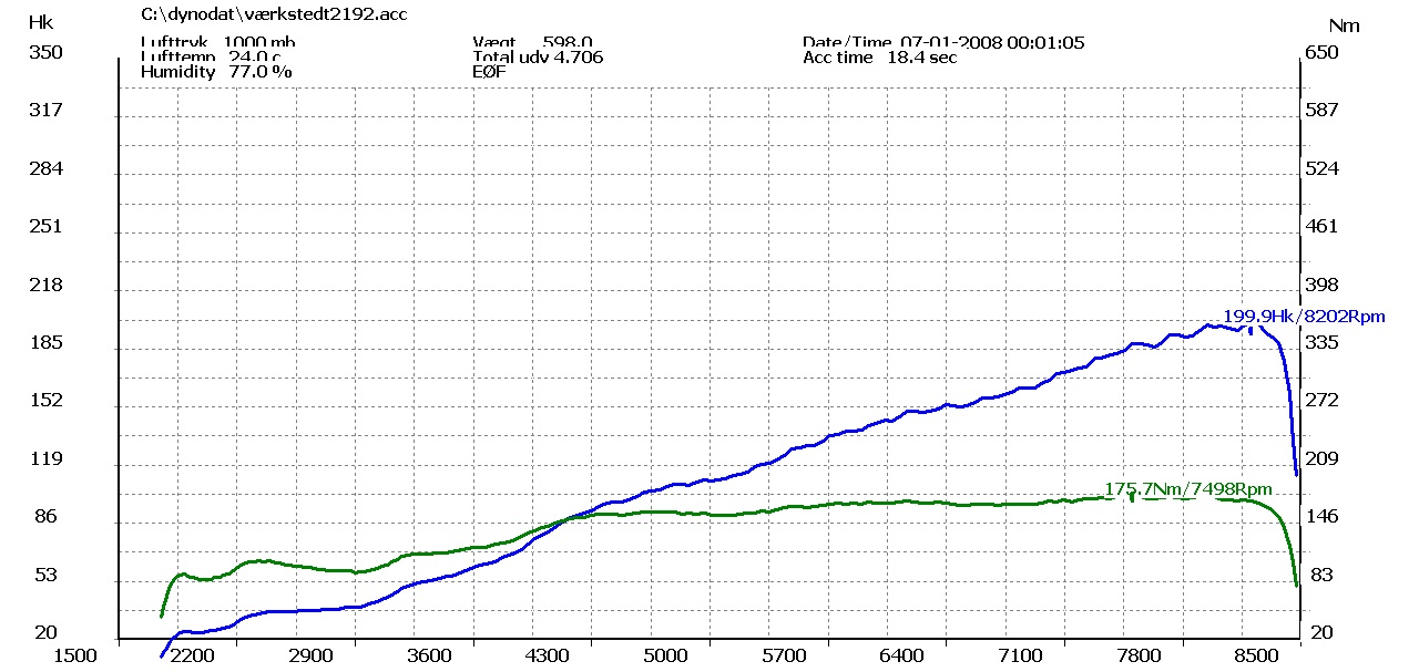

Haha - that was a joke Ivan Wink I think I can safely round up and say the 200hp goal has been achieved. But this is "only" with 8,4mm lift cams and stock valves so now I have decided to raise the ceiling.

(09-20-2016 12:25 PM)Bean Wrote:  Which cams do you use and what's your CR if I may ask.
Honestly I am not sure. I bought them second hand as Schrick 288 but I dont think they are. More likely 300 (in Toda terms). I have spend hours investigating the numbers on them with no result. My CR is 11.3.
