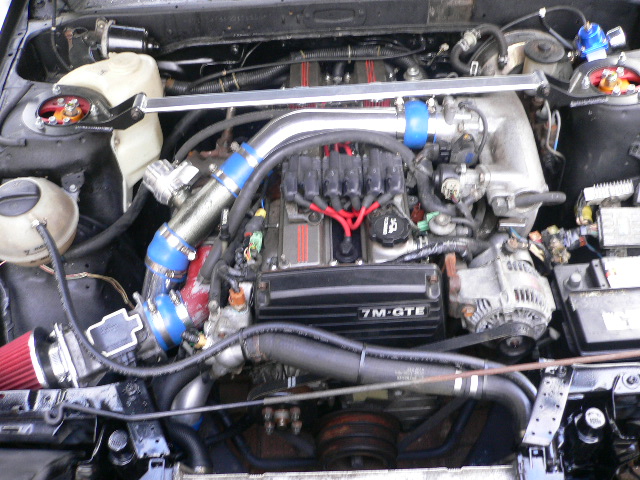

btw: where did you get that GTS front? Leftover from the ca18det? Dumb question

I got the gts front from the states had it shipped over, then the gts wiring i got from a us spec gts that is sitting here in the next town over in a toyota dealer, its now almost all stripped down mechanical wise, but all interior windows etc is all there if anyone wanted to come salvage it, its in kaislerslautern germany, i think it would sell for 100-200 euro

this is coming out awsome. cant wait to see how fast it is. i am considering doing the same thing to my car. how did the block fit. did you have to change the motor mounts alot? oh also how is the wiring on it? cant wait to see it finished. good luck

hmm lets see , all you need is oil pump and pan from a 5m motor, for motor mounts use existing ae86 chassis mounts just cut them off the subframe shorten them a few CM and the weld them close together about 5 cm, and trans mount was not that bad, wiring is easy for this motor, and other than that shes a great fit , jsut gott do the radiator a little leaned forward if u wanna fit fans, all and all i hope she will be alive soon, thanks for the thoughts kyle
