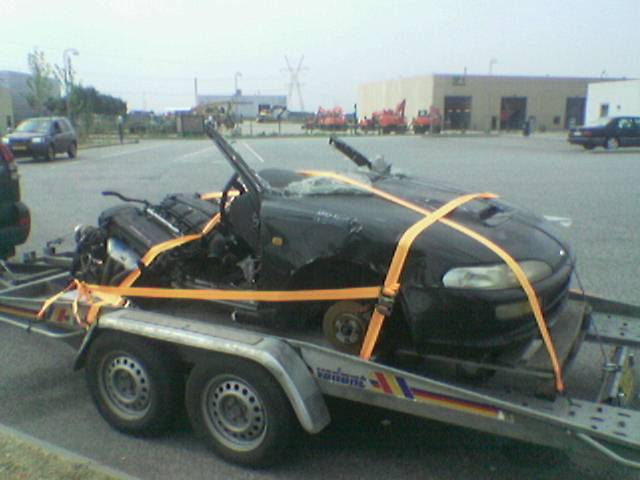

I was with my friend to pick up a frontcut from japan. We thought it was a AE101 Levin.. But the badge said Trueno on the hood.
If i do a google search on images, it seems like trueno and levin is the same body on the AE101..
Anyone knows the difference?
Thanx in advance..

I think de difference just the lamp? I dont know really... check this
Anyway you got Blacktop with it? Thumbs up!
08-03-2006, 04:24 PM
AE101 Levin & Trueno difference ?
The frontcut looks like the diff is the hood..
Engine and gearbox is the same in the 2 cars?
Frontcut is Z engine, and then 3 blacktops aswell..

the diffrence is actually the grill and bonnet maybe the bumper too ,plus they came with the 4agze or silvertop 20v

he just said it...
