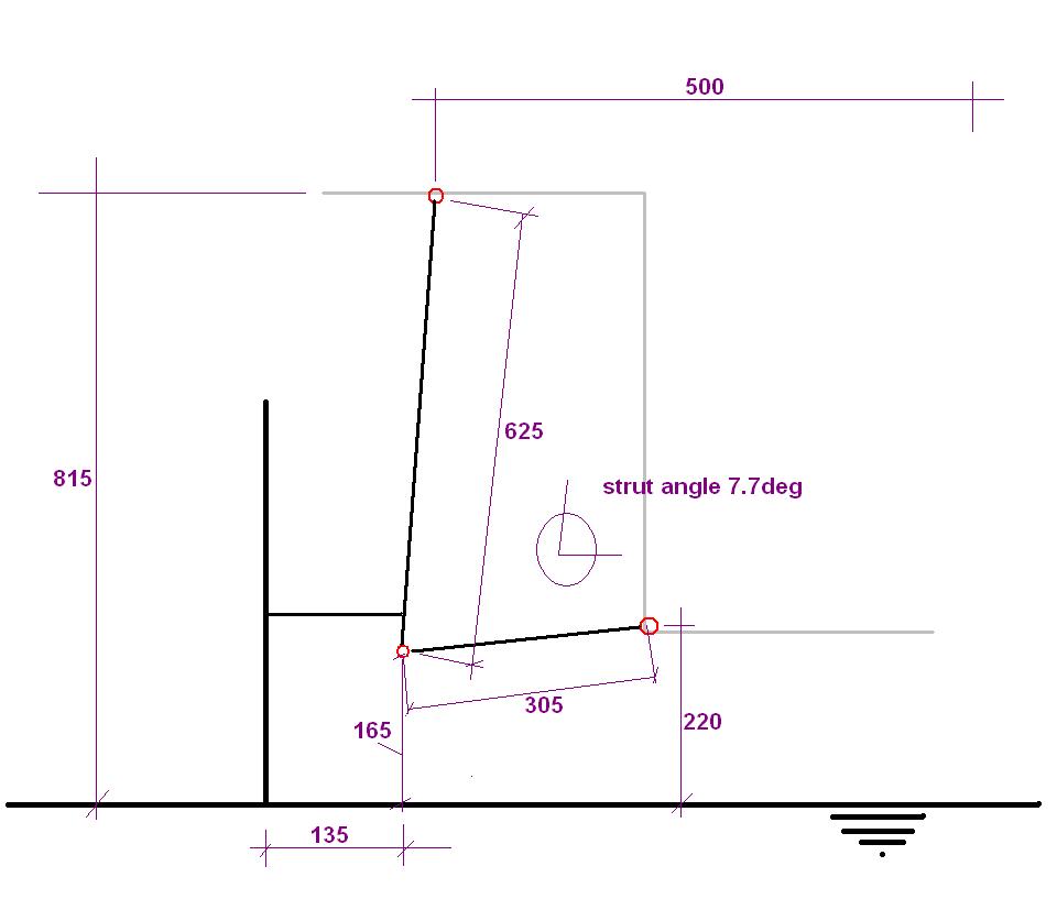

my next step will look this way:
[Image: AEU86 AE86 - All I should know about sus...dification]
but in full 3D
Herds another question, are all dimensions shown in this diagram are true ?
