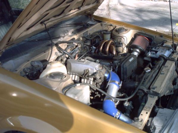

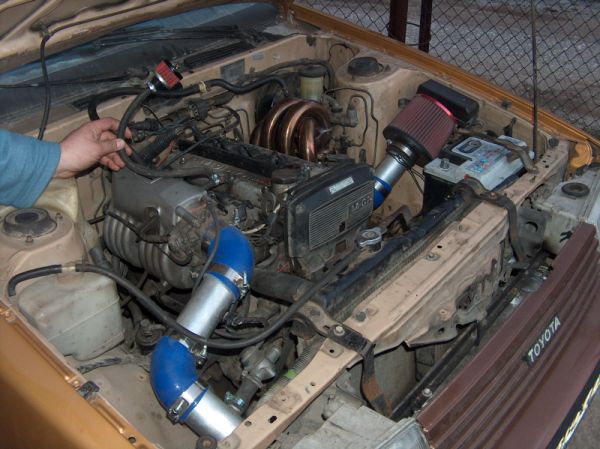

Bad_Dog from Bulgaria
went turbo.
Currently:
1. Stock MAP Bluetop;
2. MS + Stock toyota sensors
3. Toyota Celica Coil On Plug;
4. T25 turbo
5. 0.6-0.7 bar boost;
6. 440cc Supra injectors;
7. K&N filter
AE86 GTS '84 Red Top
