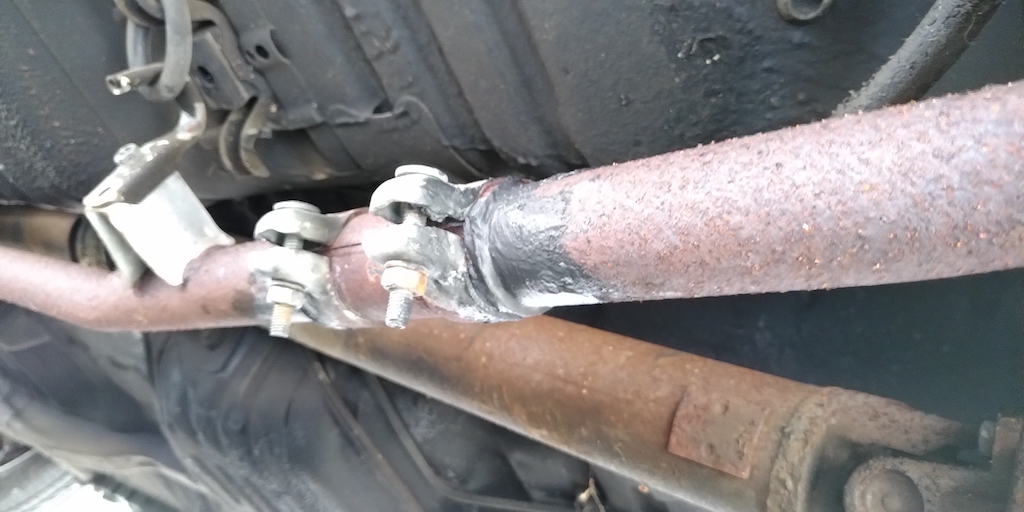

I also looked at the exhaust and found it in this condition:
[Image: AEU86 AE86 - Banpei's new TA60 family cruiser]
I loosened the bolts and found the metal was in okay condition. The problem seemed to be that due to rust the gaps were bigger and hence it was leaking.
So I applied some exhaust putty and waited for it to cure:
After the third attempt it is now fully sealed!
