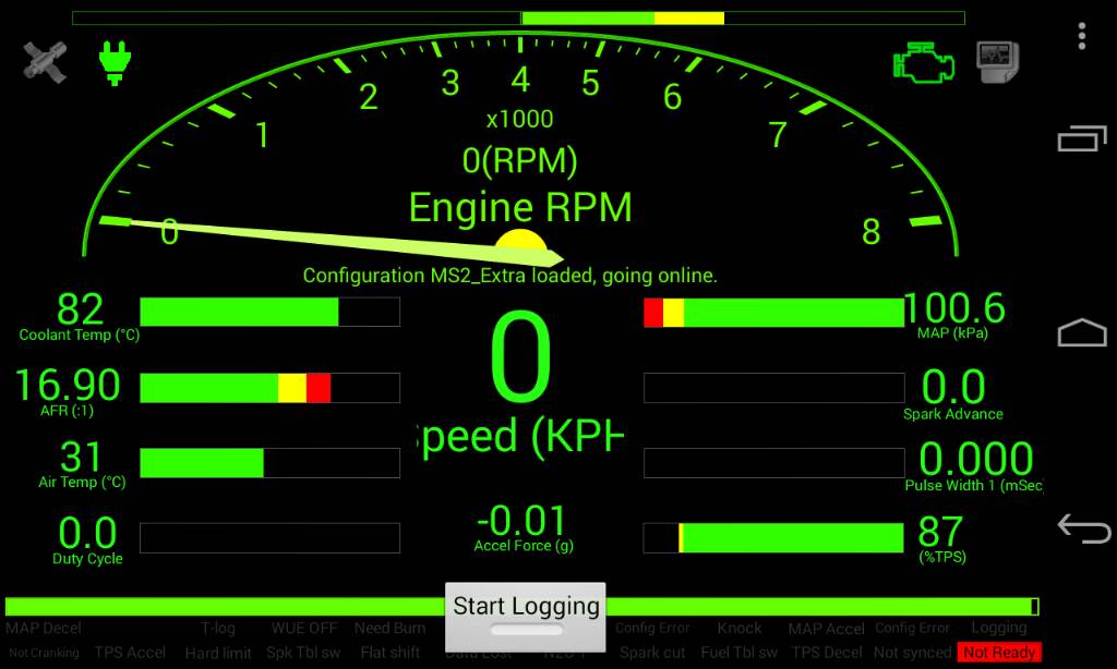

Tiny update, as I still haven't found a garage to do proper work on my car, I dug out my DIYPNP from the boxes.
Got the Bluetooth dongle installed and working. Also fitted a small switch to the casing so I can turn it of when connecting by cable or not in use.
No stim attached or any sensors apart from air temperature. And yes it is that hot in my office.
On my next trip to Switzerland I'll bring back some wiring and start with the custom harness.
Next update will be part pictures and suspension install, after more than a month the first parcel turned up (I despise local customs office and bureaucracy).
Thanks again Dan for your help!
Sent from my Nexus 4 using Tapatalk

That just a straight serial to bluetooth adapter? Nifty...

(06-12-2014 03:58 PM)Ivan141 Wrote:  That just a straight serial to bluetooth adapter? Nifty...
just a Bluetooth adapter connect straight to the CPU pins (a bit tricky to solder) but avoiding an extra circuit.

so... with the bluetooth... I can hack you from a far..... give you 50 degrees of ignition timing, while running AFRs of 18.....
