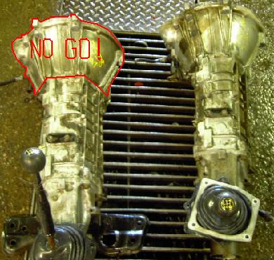

The gearbox WILL FIT your AE86
BUT..................
the part ( i have no english name for it) (in Swedish it´s called sprängkåpa)
will also fit - but the hydraulic thingy for the clutch in on the opposite side.
it will hit the exhaust pipe on the AE86.
So you need to change out this part of the gearbox - then it will fit to 100%

Bellhousing is the word.
AFAIR AE85 has same problem with gearbox clutch slave cilinder.

the easy way to get around that is simle to use some of the metal line that are used for the brakes and run over the manifold along the firewall and to the cylinder
