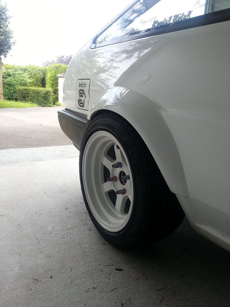

07-31-2012, 01:04 PM
Considering arch extensions
here it is Smile
07-31-2012, 02:48 PM
Oh I am truly jealous in that pic you literally have all the bodywork mods I want to do to my coupe!
I have 8j ET 0 Grid V's and was looking to use 35mm spacers so thanks for confirming they are adequate!
You done some really clean work! i think i will go down the rivet route but thanks for that you have just confirmed how good it will look!
