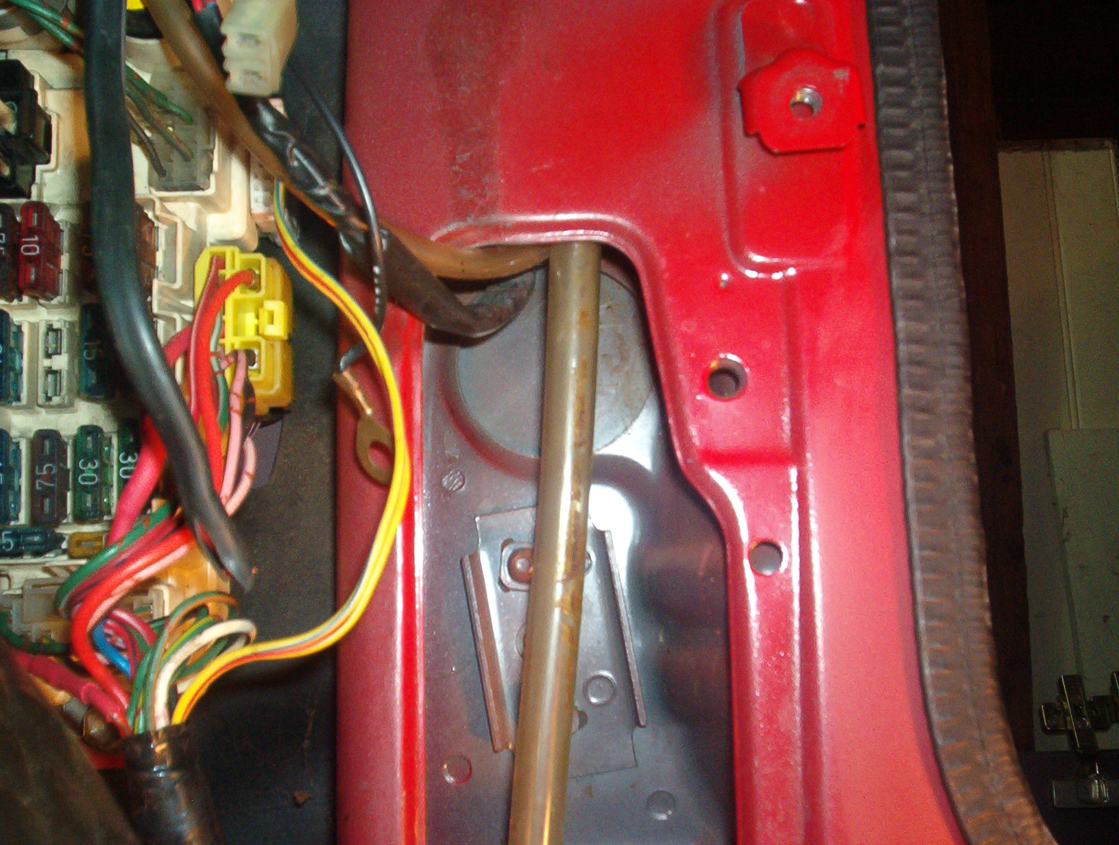

Can someone with factory fitted power mirrors, please post a picture that clearly shows exactly where the loom exits the shell and enters the door? I have been trying to work it out for a while and just now saw some pictures on ebay which give some clues.

[img name=]http://www.aeu86.org/files/im/im000385_244.jpg[/img]
After the hint I got from an ebay photo, if I look in the footwell I can see this
[img name=]http://www.aeu86.org/files/im/im000387_128.jpg[/img]
the largish circle, which i suspects needs to be drilled out to take the grommet.

Drivers side (RHS) factory fitting as far as I know. My car didn't have
electric mirrors originally, but the owner before me fitted them, and he
was the type of guy to do things properly Smile
[Image: AEU86 AE86 - Factory power mirror loom]
Sorry about the crap picture, but I couldn't open the door any further
in the garage Tongue
Cheers... jondee86

That's fantastic Jondee86. I think I am a bit like the guy you bought your car off. I want it to be exactly right. Thanks for making the effort!
