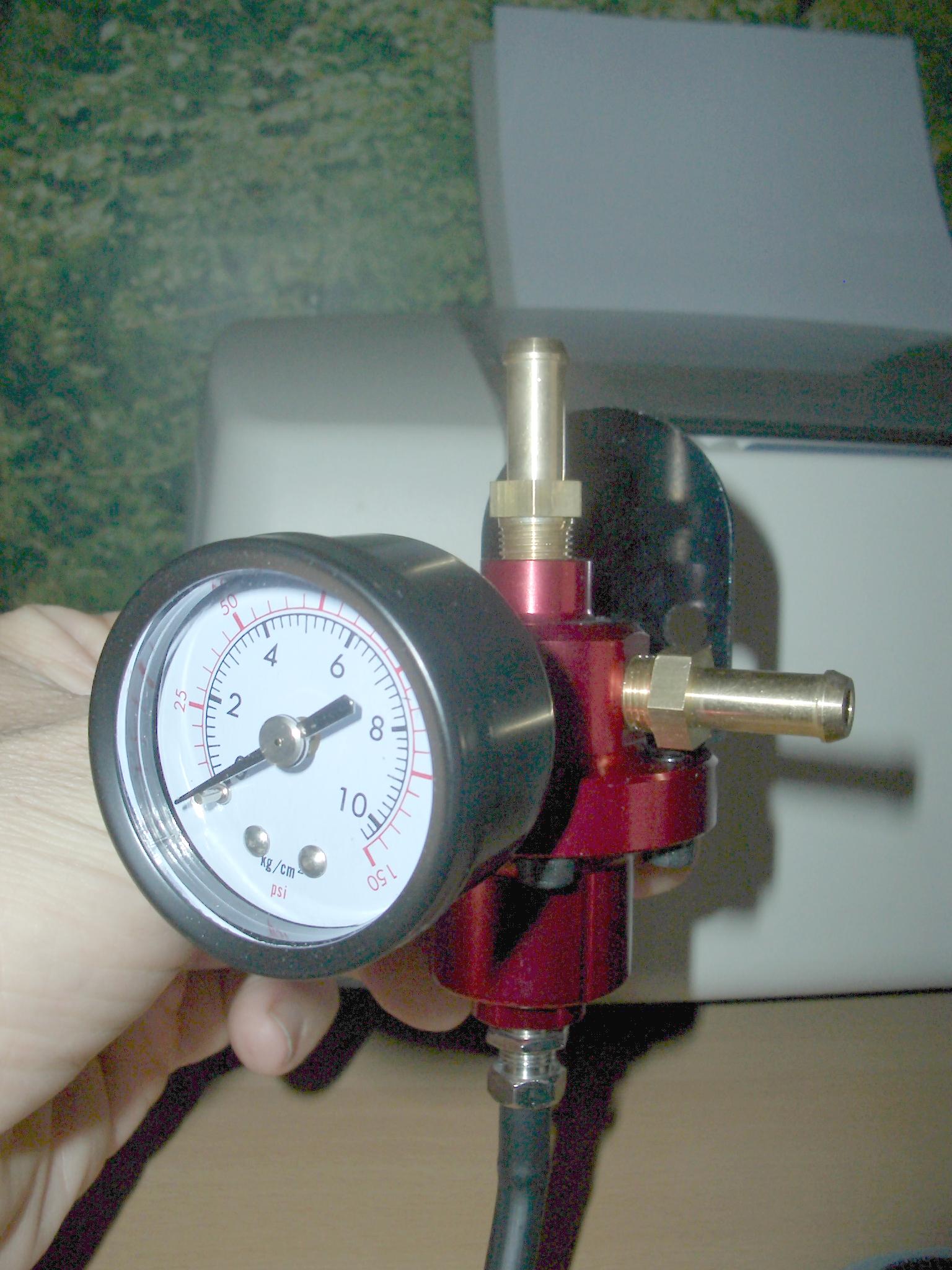

I've mounted an adjustable Fuel pressure regulator , what pressure di you think I should use . I'm not sure about the reliability of the gauge .

Try 3bar, then make series of +-0.5 bar tests (for example).

i'm at 2,8 bars at idle , 3 on charge , but I don't know the maximum pressure I can use .

I spoke to a Toyota mechanist.
He said minimum 2 bar for starting and 4.5 bars for fast driving/racing. 1984 AE 86 Levin hatchback 1989 AE 92 GTi 2004 Kawasaki KLE 500 CROATIA - small country for great drift |

thanks! I think i'll raise a little . rallye riding this week-end ,hope i can test
