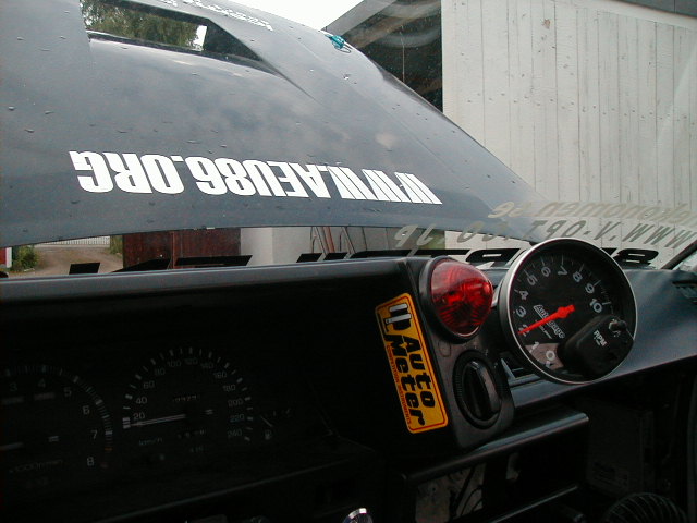

1: purchase a suitable red 12V light (or other colour you prefer)
Oops...... sorry - wrong picture... Cool

2:
here the right model of light Thumbs up! - it´s a rear facing lights for an trailer
i attached an 14W bulb - so it will SCREAM at you
For the AE86 the mountingpiont is very nice just as i have got it on my car.
