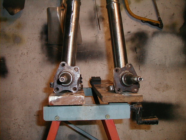

When adapting my front struts for the AE92 shocks -
I accidentially forgot to mark whick strut is left & right !
Please someone help me quick - car need to be back on its wheels
tomorrow.
Kris

Left is left and right is right! The calipers should be at the front of the strut! Thumbs up!

Check the plate which is mountet on. The space is gives is for the caliper

Yes, but don't you have your calipers out as well? If so fit one onto a strut and make sure they are in front of the strut (leading), then they are correct Big Grin
