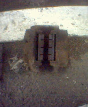

I found 4-pot front calipers from old BMW 728i. The brake disks were 280 mm, 25 mm thickness.
They need adapter plate in order to fit to AE86 mounting holes. Also I bought new adjustable brake proportion valve. |
