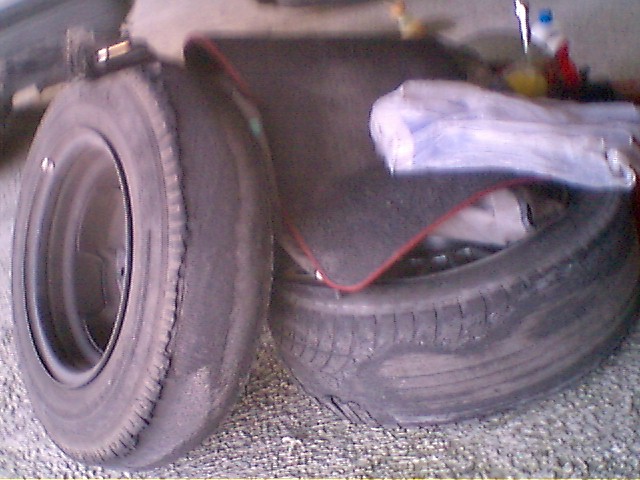

What have you done to the tyres? Huh Huh

Hashiriya Wrote:What have you done to the tyres? Huh Huh
Burn out (down)?Smile
What is the size?

3.0 bar and drift happend to the tires, not burnout

nice tires :-)

Burnout isn't fun, tires are killed in real action :wink:
