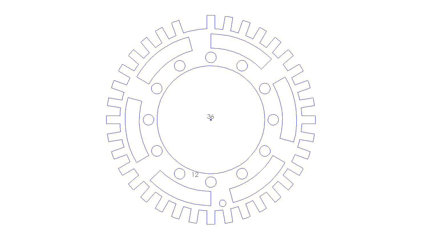

since the cast-iron crankshaft pulley is not really suited to drill and tap holes in i showed it to the guys at the toolshop from my work.They said we can make one out of aluminium on a lathe which gives a nice surface for mounting a trigger wheel.
The trigger wheel i can draw in autocad and get it lasercut. i believe dismantling the distributor and leaving only the trigger wheel intact with one tooth filed away will give me a camshaft position sensor and enough room to fit the engine without much massaging. found a perfect rwd waterpump housing on ebay but since my reputation is 0 the seller is not willing to sell, damn! just keep on looking. http://www.ebay.com/itm/1985-1987Toyota-...7e&vxp=mtr Real men race downhill |

Made a crackshaft pulley on a lathe and spark-eroded a keyway in the pulley.
Made a contact pattern and everything fits well.Next up is the trigger wheel, i drew one but can't really find the specified sizes for the teeth online so i divided the wheel op 50/50. 50% is teeth, 50% is empty.also made a hole on the other side of the missing tooth, keeping mm2 and distance from center in mind (the missing hole surface is bigger than the missing tooth surface) ofcourse any suggestions for corrections are welcome! Connected the cooling 20v FWD style and included a heater, in the meantime still looking for an rwd waterpump housing and alternator bracket, these are pretty hard to get! as a side quest i wanted to fit 1NZ coil on plugs, its not as easy as i thought, the diameter is bigger than the blacktop spark plug hole.So i tried to bring the diamater back somewhat on the lathe, the isolator housing just cracks no matter how easy i go.I measured the isolator housing but its quite thin to begin with, tried to file one down with care but the COP will just get stuck, anyone suggestions on how to do this?COP without the isolation seems a bad idea. Real men race downhill |
