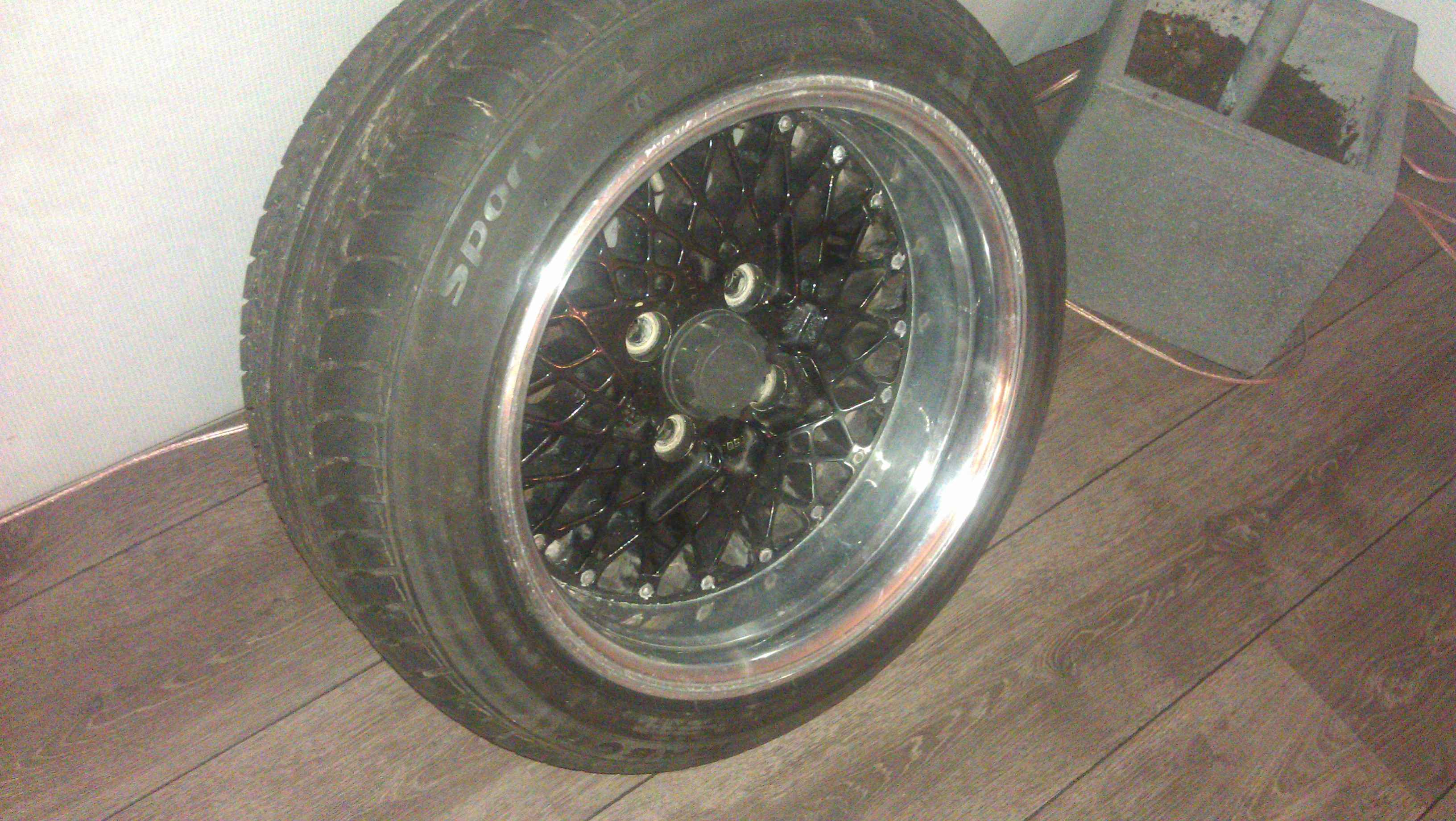

Khamsins rims look great on hachis. But I'm biased...
Where did you find those Khamsins? I used to own a set, sold them to Mux and he sold his car including them. I've only seen one other set for sale at Marktplaats, but they are not the same as yours. 1983 - AE86 Sprinter Trueno - import project 2013 - Honda Civic sport - daily driver 2004 - AEU86 dot ORG - daily domain Support our forum, buy from the AEU86 shop: |

they came with the ae86 my brother bought i think 6years ago, it was the only mod on that car.He bought that car near tilburg i think.

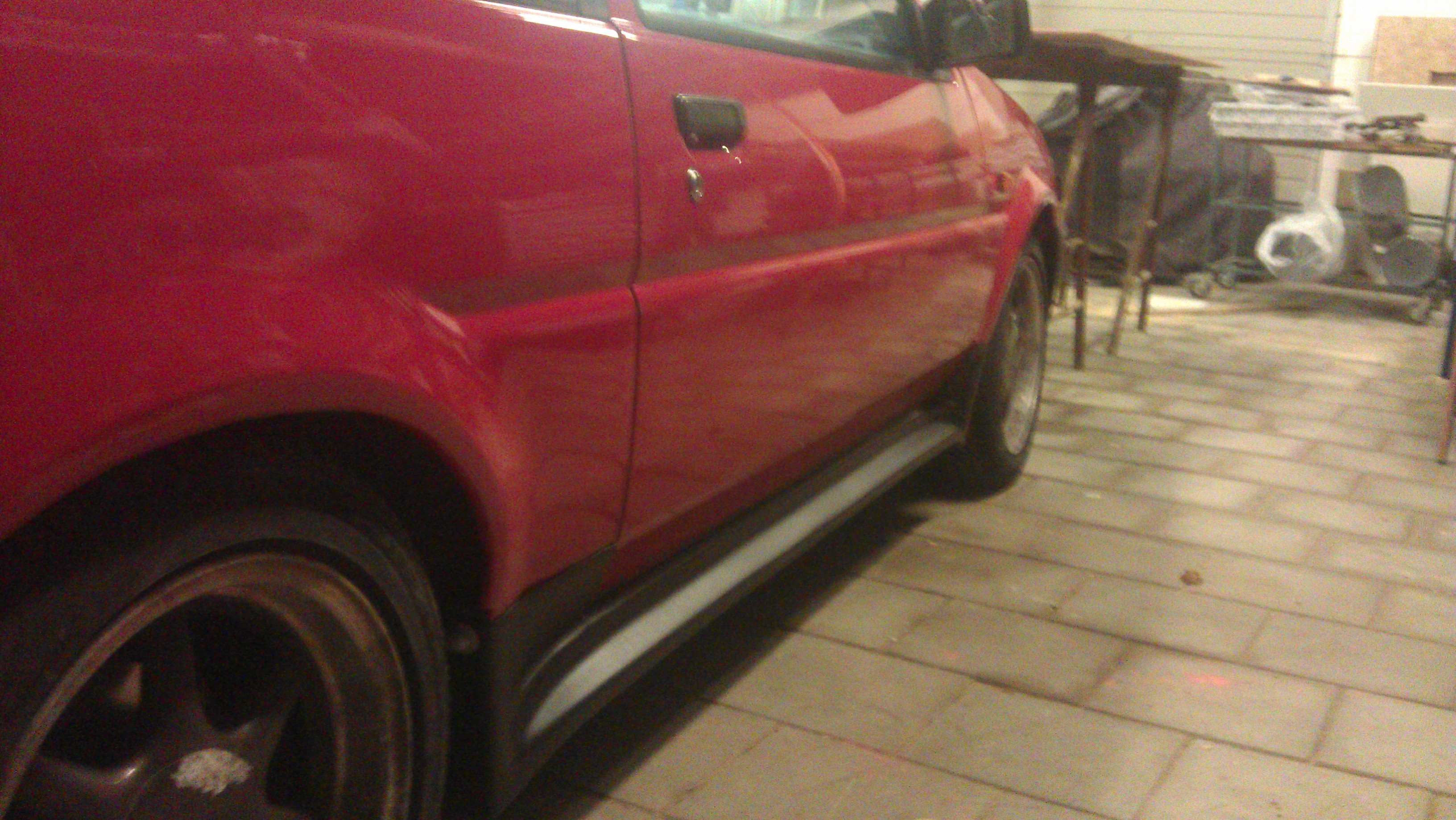

-Front fenders now painted in the right colour -Skirts painted and mounted -Rear wheel arches fixed and painted ( to the car shop dude, body shop work really is an art!) Next step: -Get those BBS E50's shining again, include 10mm spacers for the front and lower the car some more (spring hits the tire now) -MOT in January Keep you posted! Real men race downhill |

Nice going and the BBS rims would make the car a great looker!

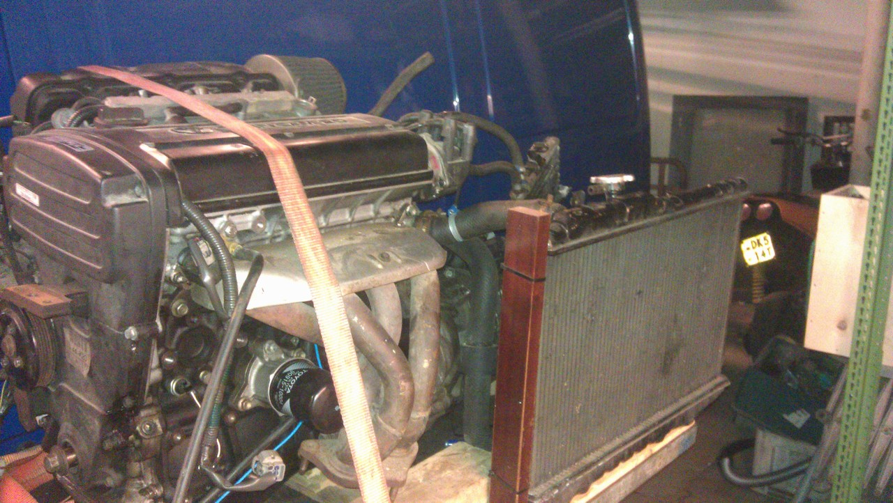

Hooked up the 20v on a stand and replaced the timing belt, hooked up the electrics and fuel to see if the engine still started and everything seems to still function just fine.Made a simple switchboard and fuel tank.
Next step will be hooking up the cooling and make the it suitable for RWD use.Now looking for an RWD pump housing. Meanwhile i will be studying/ making an approche plan for the KDFI/Megasquirt (trigger wheel? COP? Wasted spark? Camshaft sensor? which sensors can be used?) Real men race downhill |

Wouter ask Aram he has made a 20v cooling block for a blacktop.
Nice to see one is back on the road again :-) Most people use a crank trigger wheel with wasted spark. Keep the engine as simple as possible. There is a guy who uses Omex600 in NL who tunes it on a crank trigger wheel. (builds kit cars) Cars: "99 Lexus IS200 "86 AE86 Kouki Panda Levin GT-Apex (restore project) "84 AE86 Zenki Blue Levin (project racer) Motorcycles: "02 Yamaha R1 "02 Honda Hornet S "08 BMW R1200GS |

I think a camshaft sensor is probably the most reliable option combined with wasted spark.
If there is one that will fit out of the box, I dont know, but I bet someone out there tried the GZE one on for size, so google around. You could also try to make one fit, I've seen this done with volvo's (using a mitsubishi sensor). Crank triggers are ok, but due to sensor location when using a trigger wheel they are more susceptible to vibration. FABRICA MI DIEM, PVNC! |

Considered using 20v distributor?
Lose the unnecessary parts and i guess it could stay at the back of the engine without "firewall massage". |
