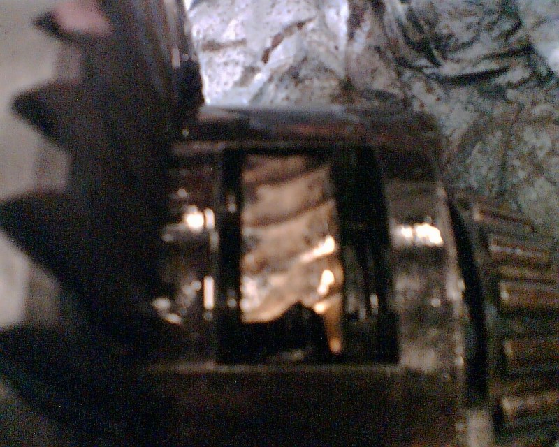

Today i disassembled my old rear axle, the one where the propellor shaft has to turn 1.5 round before the wheels begin to turn.A true mystery which is now a bit more obvious.

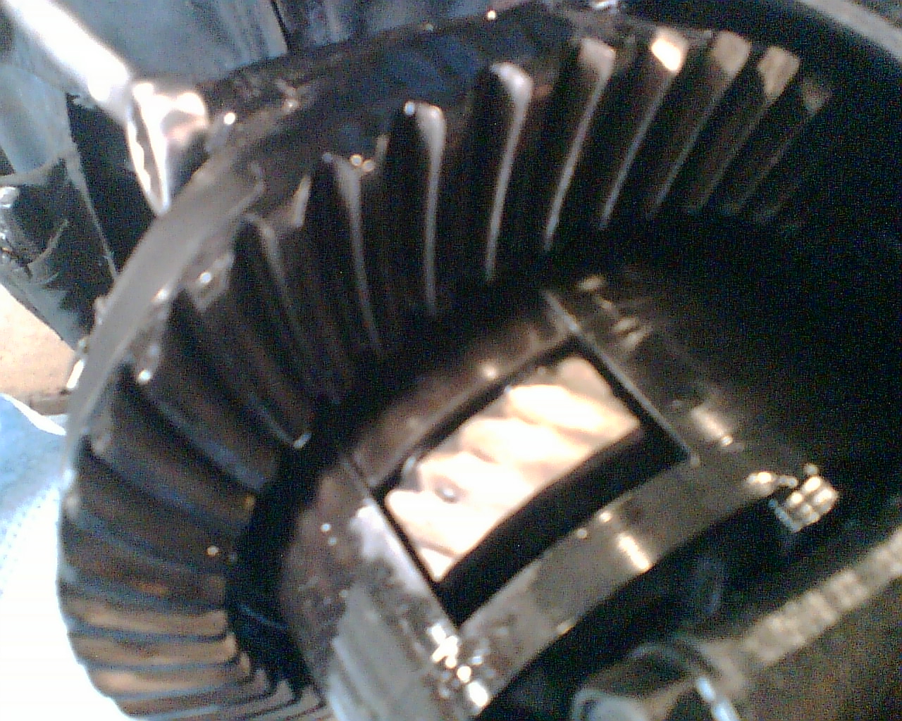

We took the unit out and at first sight everything looks ok,there is no real damage to ring and pinion,all bearings look fine and there are no teeth missing or something.
The clutch members are damaged for sure, i also found small pieces in the housing between the oil.
When i turn the pinion there seems to be nothing wrong, but when i put an axle in and stop the movements when i am turning the pinion something happens,there is a resistance building up and then something suddenly skips or something.I think it has something to do which the clutch or the LSD part.I have to take it further apart but too bad, i didn't have a fitting puller for the side bearings, maybe i'll pick one up this week.
