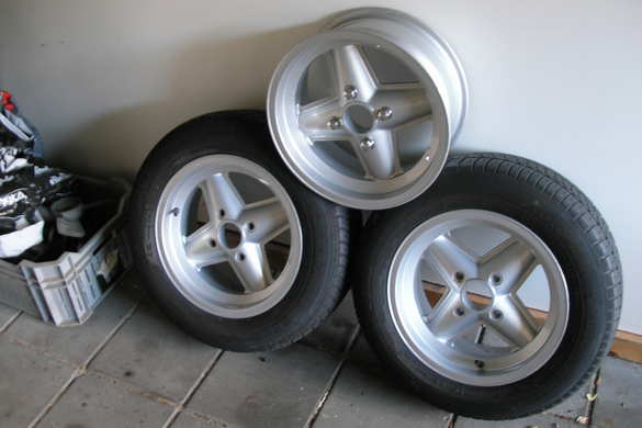

03-09-2006, 12:22 AM
Post: #50
My Red Panda :)
I just picked up this wheels today
