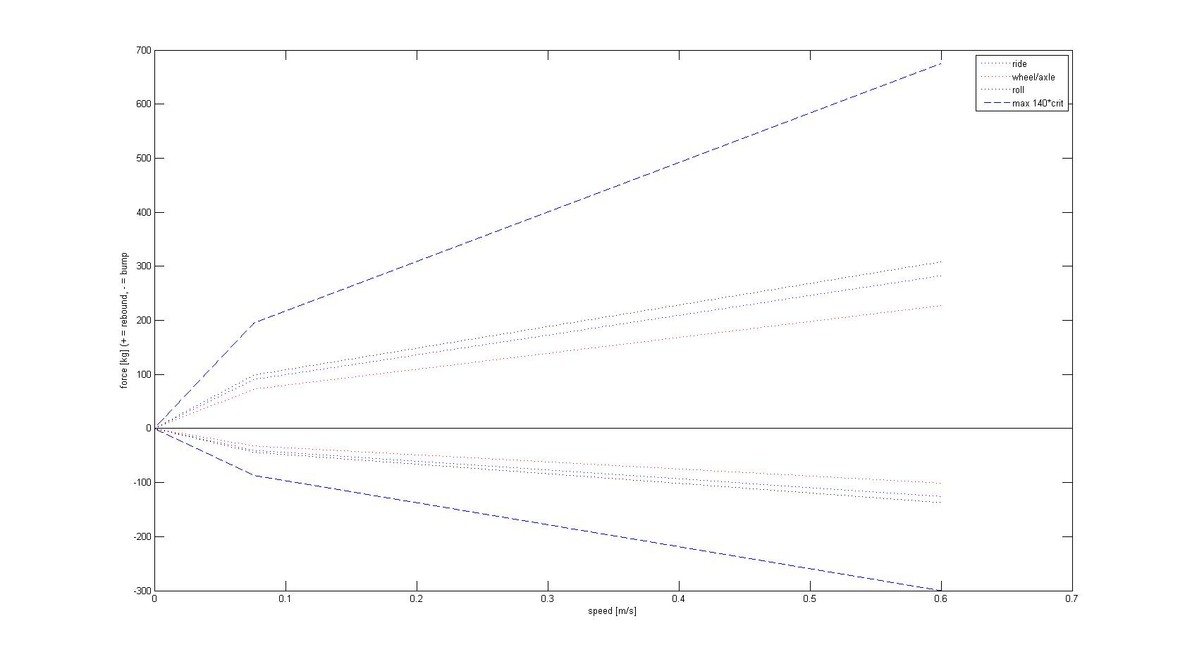

First we calculate the demands from the springs and chassis. The following graph shows the various modes 65%->40% critical damping forces and the 140% critical upper limit:

What do we see in this mess?
Well first that the HTS does indeed fall in the range between 0.5 and 1.4% of critical damping. That means that we should be able to get handling dialled in using these shocks! excellent..
The three softest settings are underdamped in both bump and rebound for optimum handling. But they are right on the curve for the high speed stuff. My guess is this feels a bit squishy when steering, but about as comfortable as you can get 8/6 springs.
Settings 4 and 5 are OK. My guess is this is what most people end up with if they adjust them based on overall feel.
6, 7, 8 are towards the overdamped range of the spectrum, but overall not bad at all.
My guess is that there is only 1 kind of HTS valving used in most if not all applications. The 86 valving seems optimised for a slightly heavier car then the AE86, probably perfect under a 1200kg 240Z. But they are suited to the 8/6 sprung AE86 very well indeed.
