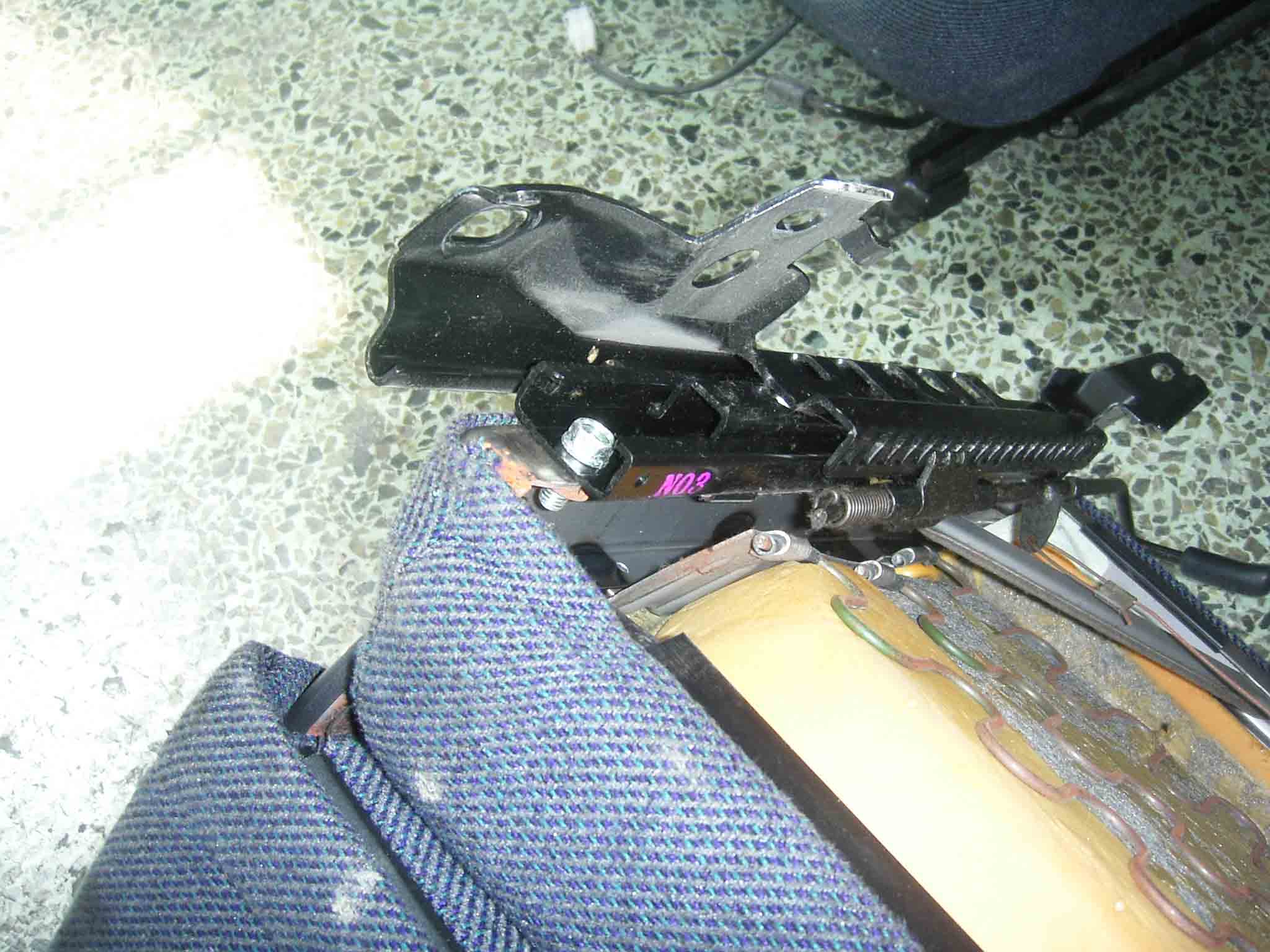

I found this dirty but in decent condition
Mk1 Impreza STi, RECARO seats.
Anybody has experience with that kind of shit:
Fiting the Recaros in the AE86????????
what about AE seat rails?????????
HEEEEELLLPPPPPP!!!!!!!!!!!!!!

If the price is right - buy them !
As seen - they can easily be dismountled from their rails.

The price is 250!!!!!!!!!!!
They will for sure need a good cleaning
and of course the rails (which are my biggest problem).
Will I be sitting to high?
Will everything work good?

In fact the front part of these rails is similar to AE86 ones, the rear section is different. Don't know about the rail-to-rail distance (measure it ?).

You can modify some standard rails to work, or get a set of rails from Japan like i had to.
New ones cost around 150 euro each delivered,
second hand around 100 euro delivered, not that cheap i know but the main problem is the rear section as the mounts are not level. but a good engineering shop could modify the ones that are on it to fit i'm sure.

I have subaru impreza seat rails in my ae86 with Sparco Evo buckets.
Not much of a problem to fit it in hachi.

I have Integra Type R Recaro seats in my Hachi, the bolt pattern on those seats was 430mm wide, as is with most Recaro seats. You should measure that.
There are a variety of seat rails available for the AE86, but I never saw a set myself and can thus not comment on seat position, quality or fitment. I heard though that Wiechers rails are of bad quality and ill-fitting.
I took my AE86 seat rails, and did a spacer to bolt them to the Recaros, it can easily be made of flat steel. I did it even twice, as I was not satisfied with the initial seat position, I moved the seat about 4cm more towards the center of the car, now the seat position is just fine.
Height is ok now, that is a point you should check before buying aftermarket rails...
hth

I bought em allready.
Damn you Zax, convinsing me Big Grin Big Grin
When I read your post I instantly went to the store!
Seats are both in excelent conditions, very dirty through Smile Smile Smile
Bolts on seat (not on rails) are:
43 cm width
36 cm lenght
Anybody knows the AE ones
