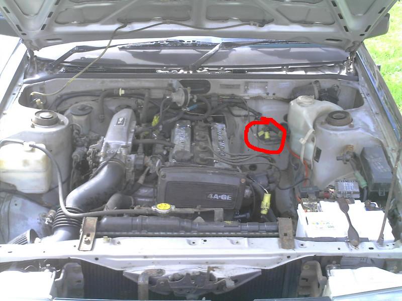

This is where its usually located on the AE86 mate.

Thanks, Is it a yellow connector? Anyone have aclose up pic?

yes it is a yellow connector, origninal it has a rubber insert thats covering the two pins of the connector.
You have to make a connection between the two pins and you can see the exact timing.
