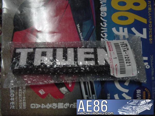

I've got the emblem on my US grille and had to use a saw to cut it back to the right proportions. The trueno emblem is about 1 inch thick, while the stock toyota emblem was about half a centimeter thick. A bit of a waste to put a saw into such an emblem.
You can also buy a new bumper, however it's not just buying a new bumper... You will need new bumper brackets and bumper lights as well since you have USDM brackets and lights which don't fit the JDM bumper. You can try to ask iCal what shipping a whole trueno bumper would cost, but my guess is that it is expensive and already has a prefitted trueno emblem. Wink
[Image: AEU86 AE86 - Trueno emblem on US hachi]

Here you can see my logo (attached)... I've used a saw to make it flat enough to fit on the grille. Oh, and I have the zenki model, so that should be the same as yours. Wink
Also the two emblems (zenki and kouki) and from what I see the kouki is slightly less thick. Don't have a picture of the zenki emblem, but the kouki is at hachi-roku.com. Dunno about the mounting points for the kouki, but for the zenki it is a single screw. Smile
