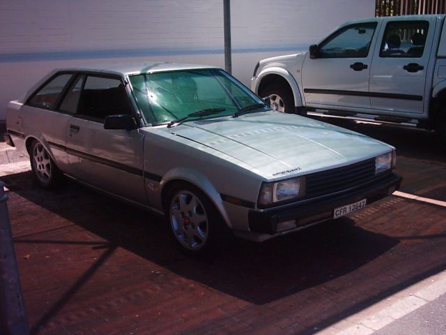

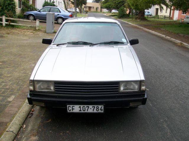

The 1.6SE Lift Back came with a 2T motor with the dual carbs where as the 1.8SE Lift Back came with a single carb.
I had the 1.8SE and my dad had a 1.6 SE back in the days. There is a lot of differences with the front grill and lights, back lights, bumpers front and back as well as different clusters. Below are pictures of my Lift back and do I miss her. I had a set of 45 Dellorto side draughts with a Cowley branch(Headers), 57mm SSteel exhaust front to back, port&polish head that was gasflowed and a 280 degree camshaft. I made 150HP and 149NM...I was planning on dropping a 3SGTE in but saw my current AE92 and decided to sell the Lift Back which was the wrong thing to do. I had a set of 15's Nissan 200SX rims on Current - 2006 Run X RSI TRD spec Current - 1991 AE92 Conquest 4AGTE Ex - 1992 AE92 Corolla 4AGTE(175KW&295NM) Ex - 1983 1.8 SE Liftback(headworks and side draughts) |
