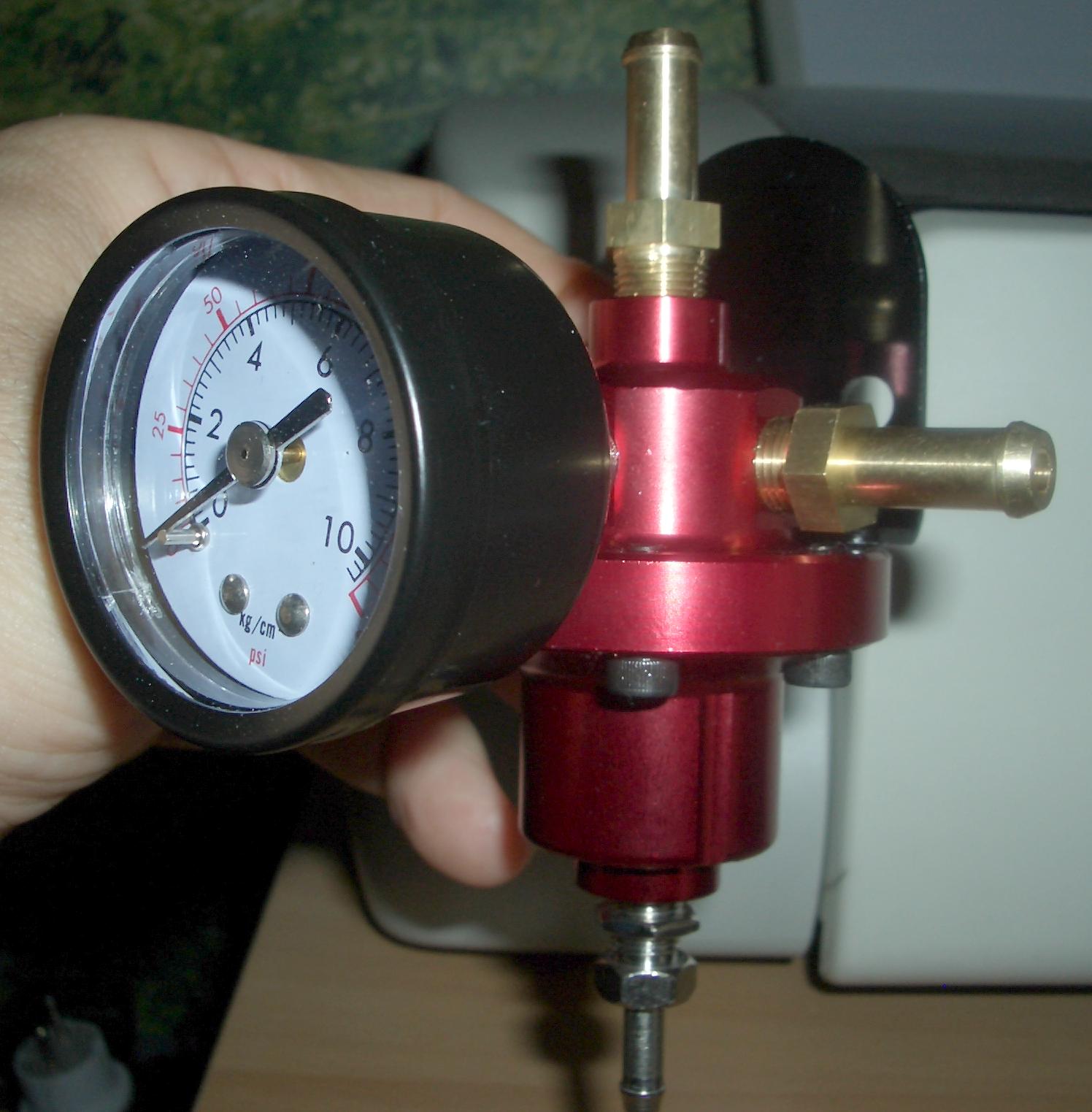

Hello,
I'd like to have advices and pics about fixing adjustable FPR on Fuel rail,
on my 4age .
PIcs are really helpfull .
Thanks
Filh

thks , I 've already read that post , but I can't find a pic of FPR fixed on rail. The stock one is bolted with two screws and I'm not too happy about drilling a new hole in rail !
Fil4545

Usually they are not on the fuelrail, but in the flexible fuelline right after the fuel rail..just cut it and place the FPR in between with some hoseclamps..Remove old FPR, leave pulsation damper in place and gut the original FPR mechanism of its internals..that will do as a plug for the hole thats created.

you mean , inserting the Adjustable FPR before the stock one ,on the flexible fuel line , and trying to get the stock one free for the pressurized fuel ?
filh
