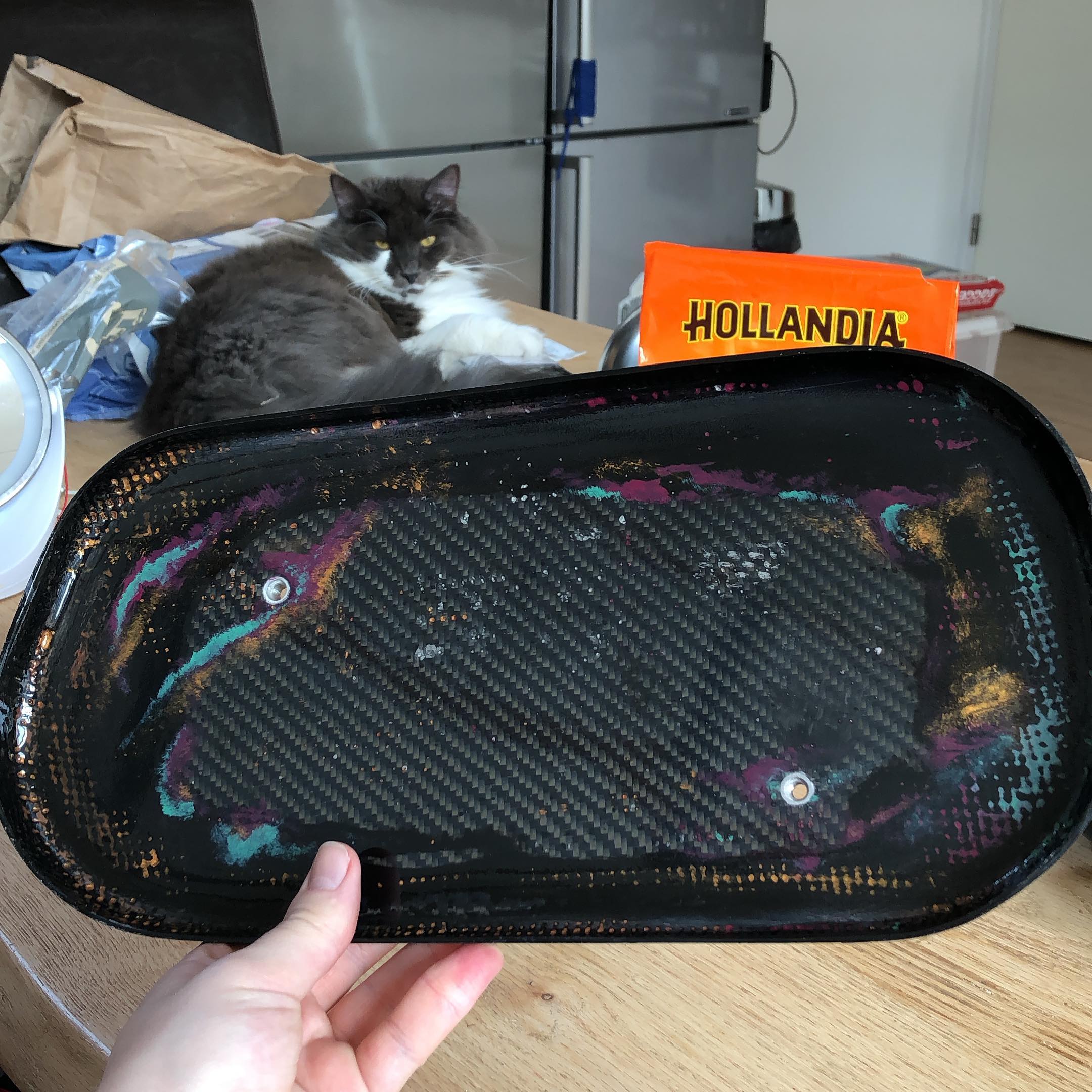

03-21-2024, 02:20 PM
the noby booth chronicles
baseplate is kinda straight now and has been coated with epoxy... couldn't help but make it a modern art piece |
