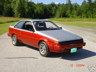

is it worth turboing a 4AGE. cause i want to get more power out of my ae86. or should i go with a motor swap with the silver top 20v. i dont have much money so things would be bought on buget. or are there other option that i have. anything woud be helpful. as of right now the car has a header back exhaust trd cams, light weight flywheel, stage 1 clutch posi rear end and shorter gears dont know exactly what the ratio is. and it has trd springs all the way around with tokico struts. but there is jsut not enough. i cam from driving a v8 to this so i am use to loads of torque. as i said earlier any thoughts or comments would be great. oh also i am getting the trd short through shifter soon. and 4 link bars for my car. i have bad wheel hope.
