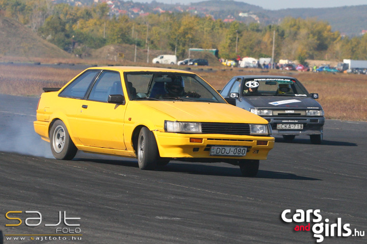

Here is a picture about my mate and me drifting last weekend.
