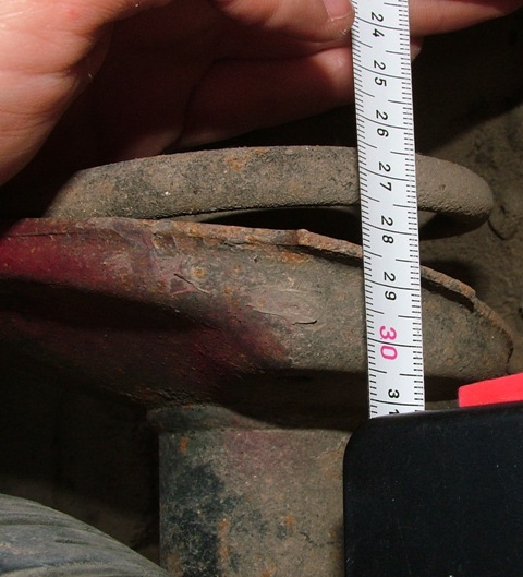

Yesterday, I’ve pulled up front end and measured the preloaded spring length in strut, with out car weight. It was 30cm from top seat to bottom seat. So, any spring shorter then 30cm can not be replaceable with OEM spring.
Btune spring has 21.6 cm free length, so I will have around 8 cm of “free play”.
Fun is not the straight line!
