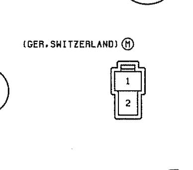

Connector should look something like this:
[Image: AEU86 AE86 - Disabling the speed warning... JDM Levin]

banpei: thanks Big Grin so the blue plug I found floating free has nothing to do with the chime. Nice. Now the hunt is on for something that looks like that t-ish plug. (I did find the space behind a small circular grill, that sits on the other side of the cigarette-lighter/ashtray box combination, aka central console), but well, a freefloating chime just for testing purposes, if I have tho connector, won't be too bad Smile
Well, here's to some time, and hopefully a first succesfull euro levin chime installation soon Cool
