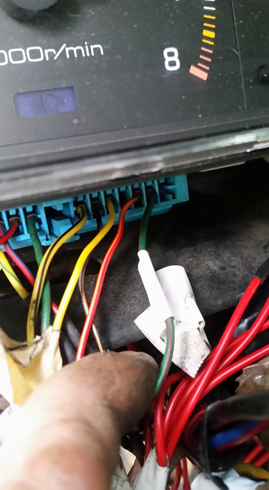

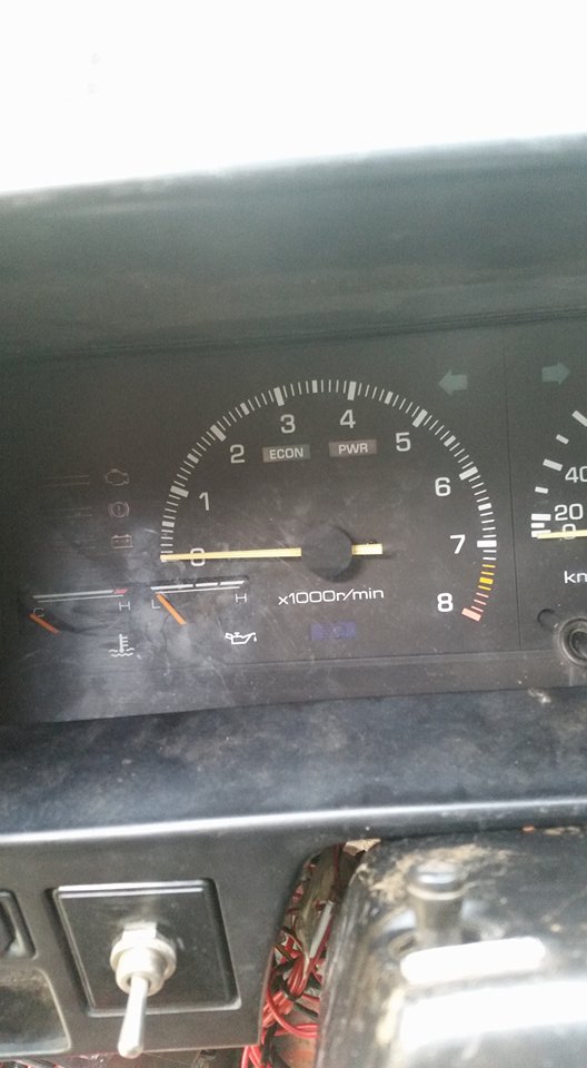

I want this PWR light (Novelty item, I know) working (Since I have it, and it`s cool):
I know which wire it is, #2 Green-Red:
I traced it to the engine bay K plug:

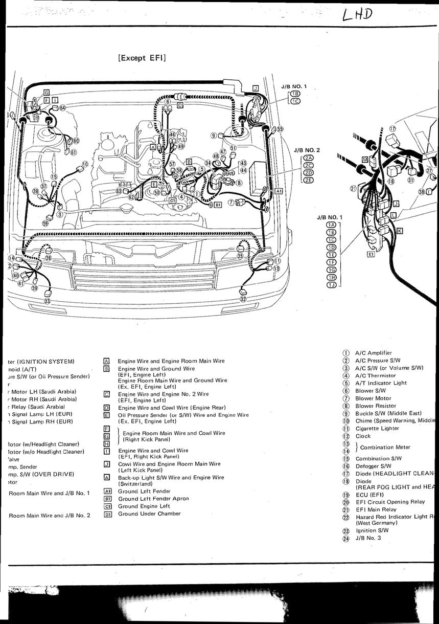

And according to the wiring diagram it should be like so:

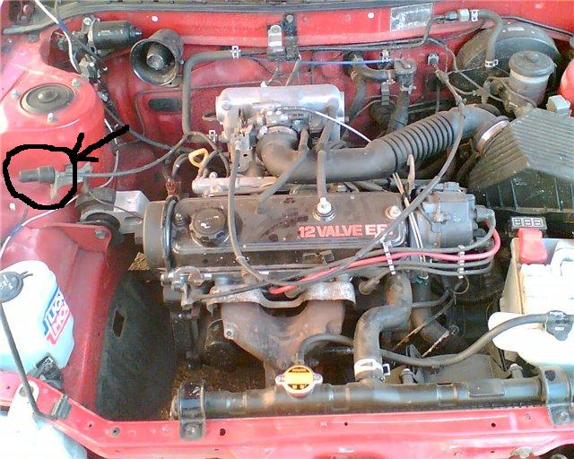

Problem is though, I looked at the placement of all stuff in engine bay:
And I`ve found VSV for T-VIS, 12v power supply Black-Red wire on 14P (G) plug on Junction Box No.4, Ground via #9 pin on ECU 18P (at around 4500rpm).
I`ve found idle VSV that is controlled by Idle-Up Computer.
And I`ve found the secondary A/C idle VSV.
But I cannot find any earthed VSV (K plug) for the PWR lamp...
Any takers? Smile

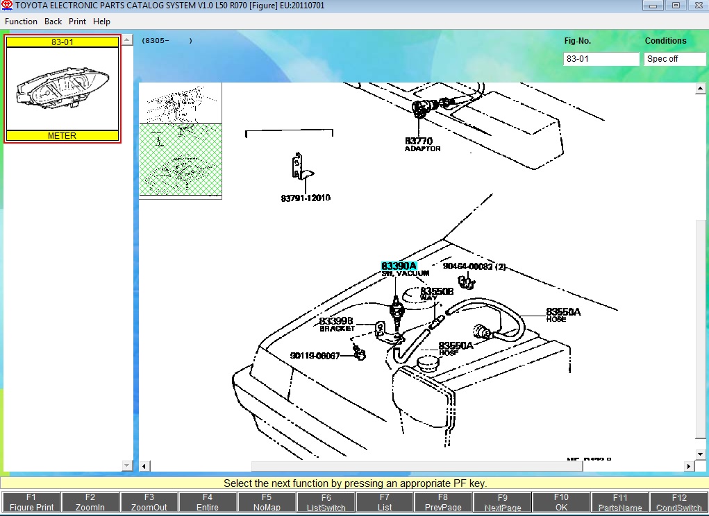

Ah, finally I was able to access a proper EPC and found the elusive Vacuum switch!
Now to get one Smile
Case closed!
Edit: Picture of how it looks like and parts number, for future reference to others:
Parts name and number:
SWITCH ASSY, VACUUM(FOR ECONOMETER)
83391-16020
