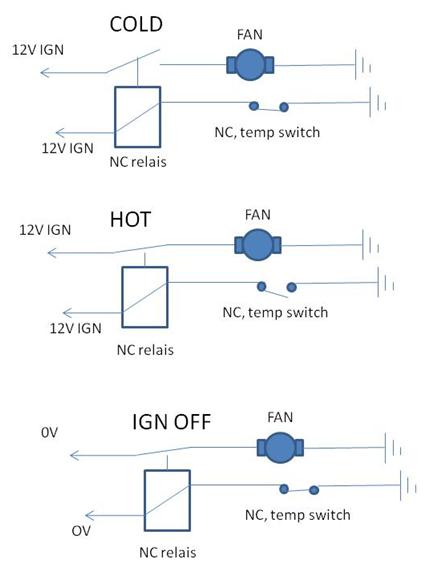

fax0815 Wrote:I´m getting confused, does your switch open or close at a certain temperature? Hello fax, One thing is for sure the setup woks I use NC temp switch (OE toyota) and NC relais. Wityh NO relais it doesn't work. I made a quick electrical layout. I hope it's clear As you can see with IG OFF contact will be closed so direct supply from the battery will keep the fan running all the time. Or I need permanent power to the relais but it will empty the batt.also at the end. About the curent the fan is using... after hearing about impressive numbers up to 30Amps I measured the current myself: At start up it peaks until 8A. Afterwards it runs with around 4A. I fused it with 10A to be save and rapidly switch it on and off for several times ... fuse didn't blow. Now I use 15A fuse. I drove it (7°C outside) for several km's. after stationary running the engine for 5-10min. the fan turned on for <1min and switch off again. after 5min it switches on again for less than a minute. So I guess cooling is sufficient. Hopefully it will be the same in summer.... |

Thanks, thats what drawings are there for, explaining things easy without to many words
Looks like a 1,5mm^2 so it should be fine with 15A The thing is your fan is stock so not very effective / powerfull, if you run like a proper Pacet, Spal fan, I´m telling you they take more than that. I´ve had a twin speed Kenlowe and if blew 30A everytime... 1979 Toyota Corolla KE35 1983 Toyota Corolla AE86 1985 Toyota Corolla AE86 |

fax0815 Wrote:Thanks, thats what drawings are there for, explaining things easy without to many words The initial plan was to put PACET in until I found this Corolla E10 Fan for 5euro ... well now I still have a few months until summer to find a proper wire to feed the pacet On the other hand I do not drive it on track or races (only regularity rallies) so the E10 fan might do. I know, there is no need for an E-fan than but I just like building these kind of things |
