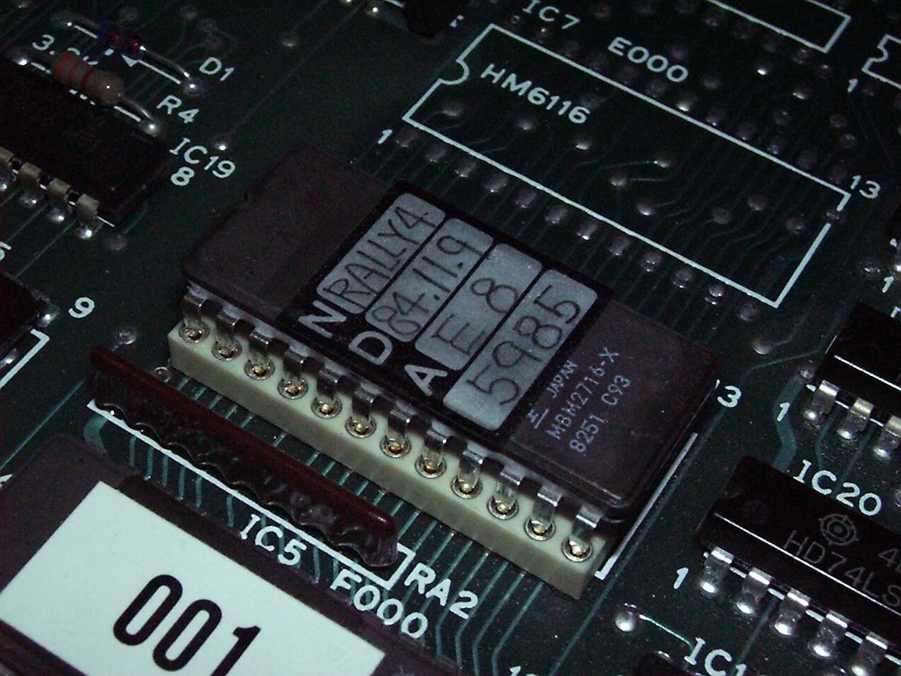

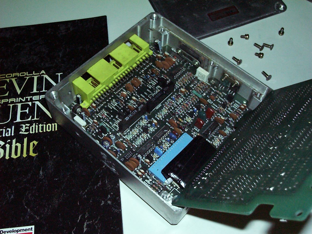

Hmm, the ECU we had used two EPROMs - both were socketed on the top board. From what I was able to find out, one apparently contained all the executable program code and the other one contained the maps and other data. I should have a few photos of the board on my home PC - I'll post them when I get back home from work.
It could be that on later revisions of the ECU the EPROM containing the program code was soldered directly on the board.
Edit; Ok, I remembered incorrectly - the program EPROM (2732 marked '001') _is_ soldered to the board. So in order to dump an image, it would have to be soldered off the board and socketed.

That ECU is similar to mine...
So, if i want to edit the maps i have to read the eprom that's soldered to the board?
What information is in the eprom that is fitted to the socket (the one with rally marked).

09-14-2007, 09:17 AM
I have a TRD ECU but...
The actual maps are most probably stored in the socketed EPROM chip ("RALLY4") but it would be very difficult to know exactly which address they're located on within the image. In order to find this out, we'd need to disassemble and analyze the actual program code which the ECU is running and figure out how it accesses the maps. And to be able to do this, we'd also need an image of the program code, which I believe is on the other EPROM ("001"), soldered on the board.
