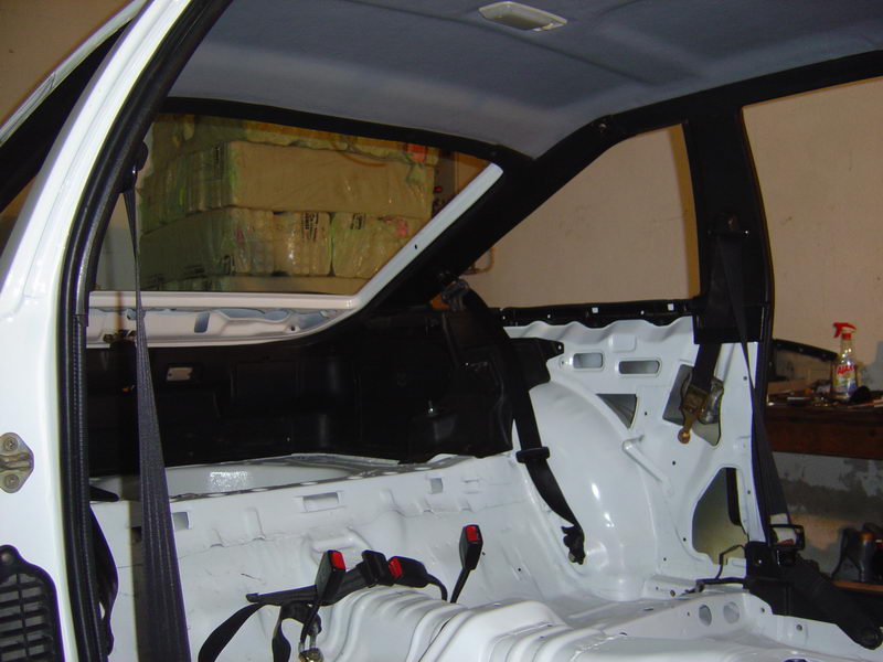

Yesterday I got a call from Robokill while he was installing his seatbelts. He had exactly the same problem as I did when I installed the seatbelts: don't mix up your seatbelts. They fit on both sides but don't release the belt when mixed up. The only way to distinguish them is by looking at the plastic cover: it doesn't fit that well if you mix them up, but if you have stipped your car like Robokill you can't tell the difference. Wink
If you remove your belts from the car: don't let them roll up, keep them as long as you can. Also mark them left and right to prevent confusion. Smile
Edit: I've used Apardal's rebuild to show the seatbelts
[Image: AEU86 AE86 - Installing seatbelts]
