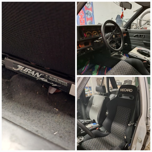

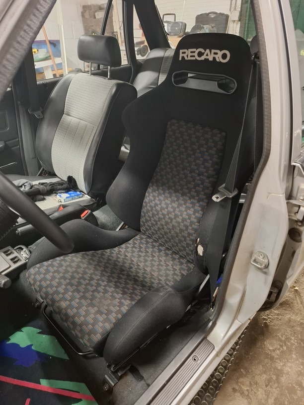

I made a seatbracket for my Recaro seat out of one of the original seatframes, but I was never satisfied with the result. Seatposition was too high and not enough adjustment.
So I bought a AE86 Juran Racing seatframe specific for Recaro SR Seats. Had to cut and reposition the 2 left mounting brackets as the spacing was slightly different for the Charmant (1.5CM too wide in the front and 1CM too wide in the rear). No big deal, easy to adjust.
Very happy with the seat position now! Nice and low and allot more sliding adjustment.

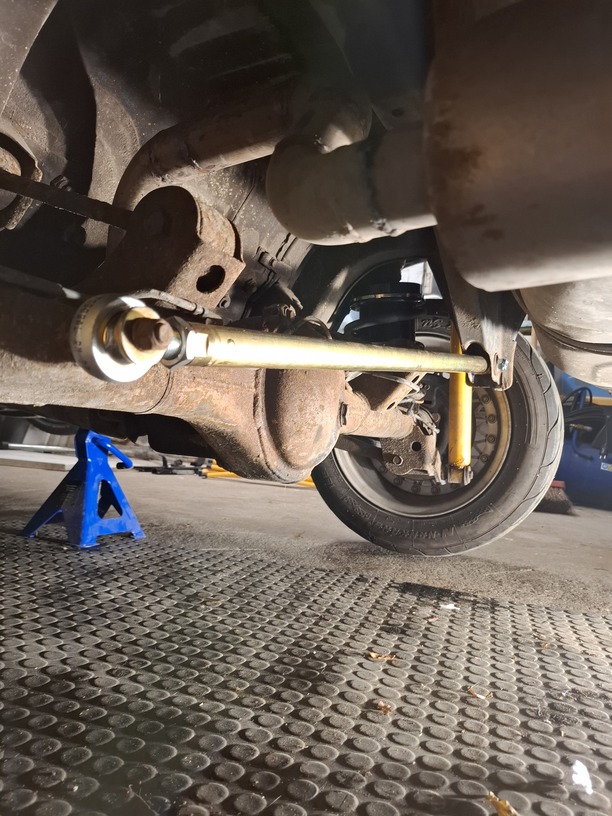

Also fitted a adjustable panhard bar from Flo's. Passenger wheel was slightly rubbing due to lowering.

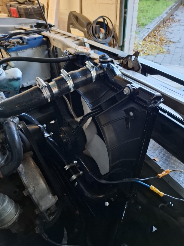

And the last thing I did was upgrade my cooling situation. I had a very slight leak in my original radiator. Offcourse, finding a new original (or OEM Spec) is unobtanium. I wasn't too keen on putting a big alloy one in there. Luckily I found a near new original Denso Honda Civic EG radiator with electric fan. Went and picked it up in Den Haag, ordered some silicone hoses etc and fitted it. It works very well, a little bit too well actually. During driving it struggles to get to temp (the weather isn't also helping). I also found out that the previous owner put a 82deg thermostat in there. I've got a new 88deg one laying around here, so I'm gonna fit that and hope it solves the 'issue'.
Oh and don't worry about the fan connectors on the pic, that was just for testing. I've now put some Deutsch connectors on there Hurray!

Kevin, nice work, just one piece of advice on the new radiator:
It might be working great now in wintertime, but I can see the floor through the front holes left by the narrower radiator, and that is never a good thing. You want ALL the air to pass through the radiator, not around it. If air can go around it, the pressure in the engine bay and in front of the radiator will get almost equal and the effectiveness of your radiator will drop badly. Put in some sheeting (metal, plastic, whatever) to close up the gaps, and if it cools too much in winter cover a part of the radiator with cardboard.
01-09-2025, 12:04 PM (This post was last modified: 01-09-2025 12:05 PM by KevinC.)
Kevin's A35 Daihatsu Charmant
(01-08-2025 09:04 AM)Ivan141 Wrote:  Kevin, nice work, just one piece of advice on the new radiator:
Thanks! I'll keep an eye on it and see how it works out when it's warmer again Thumbs up!
I still have the metal part wich covered the left side, so I'll check to fit it there.
