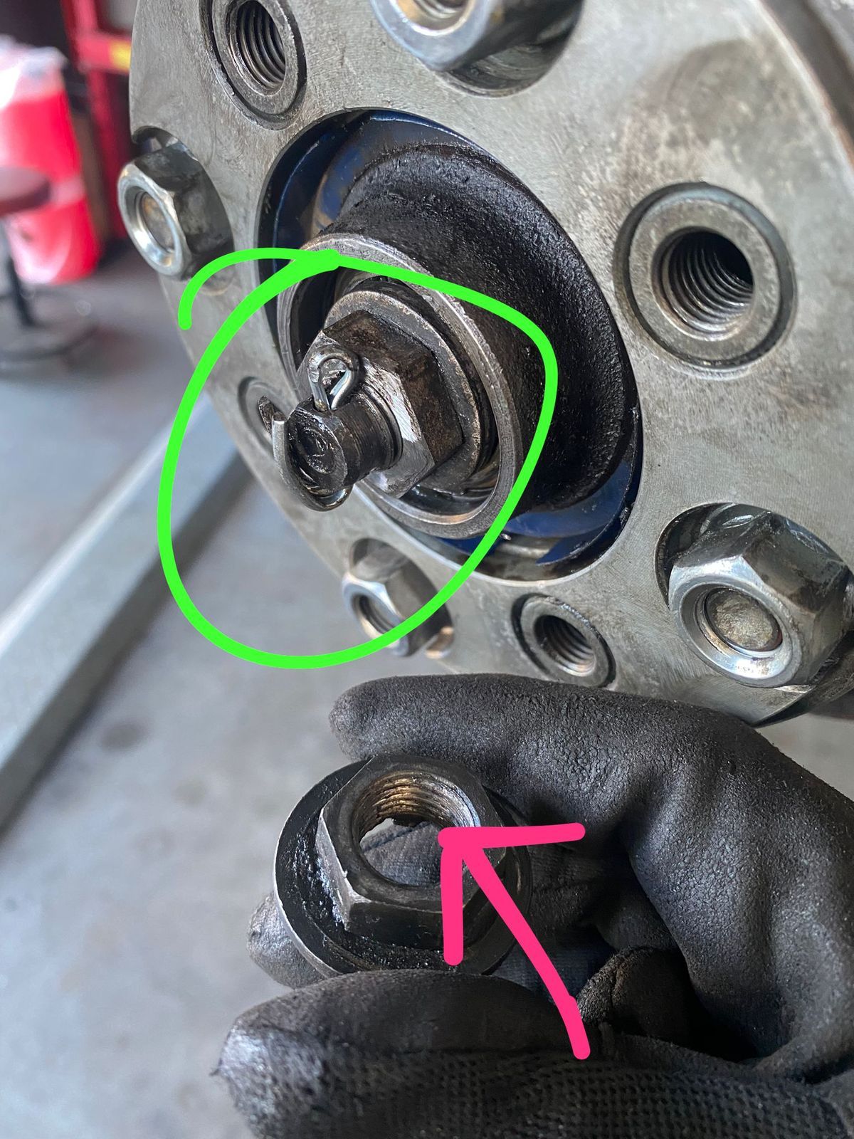

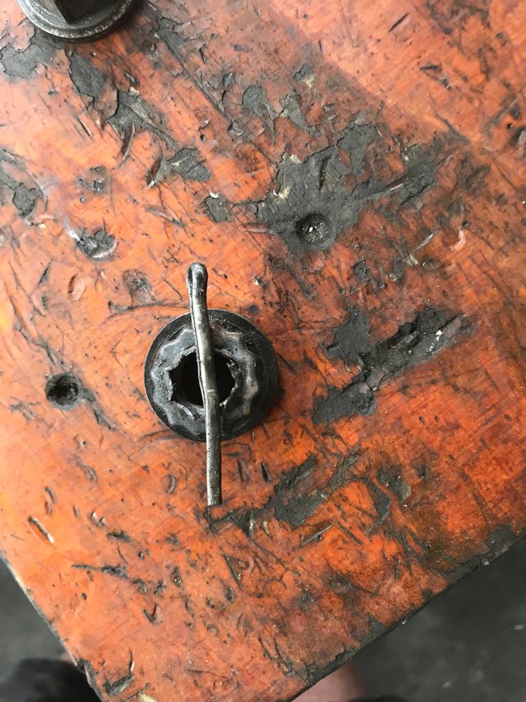

A bolt, a nut and a pin on the front axle have recently worn out, to which I can't drive unless it has been fixed. I found out during repairs I need new ones, but specifically made for the front axle of the ae86. I have pictures added below of them below. Can anyone help find out where I can get them? That would be great!

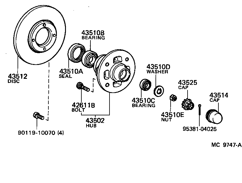

Washer: 90214-16010
Nut: 94125-41600 (replace: 90170-16137)
Cap (locking washer): 43525-20011
Pin: 95381-04025
I would also recommend buying new caps: 43514-20010
