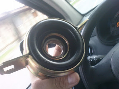

I found picture of AE86 center bearing support:
[Image: AEU86 AE86 - Propshaft options]
Many Toyotas from that time, +- 10 years have same bearings, the difference is how they are connected to chassis.
Examples:
10-15-2010, 05:22 PM
Propshaft options
so i could just take any bearing from that time and take the center piece and put chassis connection from my old bearing? Smile
and off course messure center hole that can fit...
