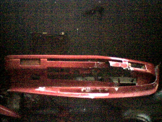

Today we started taking out destroyed parts of my car Crying
Here are some pics from my cell phone...
Tomorrow i'll have some better ones...
