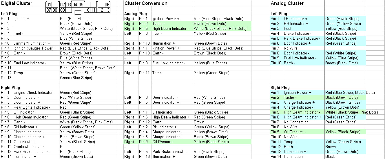

The wire (according to this diagram http://www.aeu86.org/download/ae86/id/8330) is black with brown dots. I recently had trouble getting this working myself recently and opted to use my friends kindly donated aftermarket tacho. Good luck.
