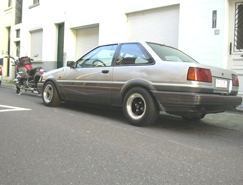

10-21-2004, 06:35 PM
The parts that matter on my AE coupe
Finally got 4 the same wheels on the car, brand, not size and colour!
![]() Also got the cage in. ![]() |

2 rikard: nice coupe you have! i like polished lip rims.
I tinted my lights black, but i like your red ones. Drifting - best fun you can have in your car with your pants on! |
10-21-2004, 10:53 PM
Post: #20
ZaX Wrote:2 rikard: nice coupe you have! i like polished lip rims.Thanks! The lights were like that when I bought it, actually, I have not done anything to the exterior except remove the rear spoiler ![]() As for the rims, I am thinking about painting them either all black or all silver (keeping the polished lip offcourse ![]() |
