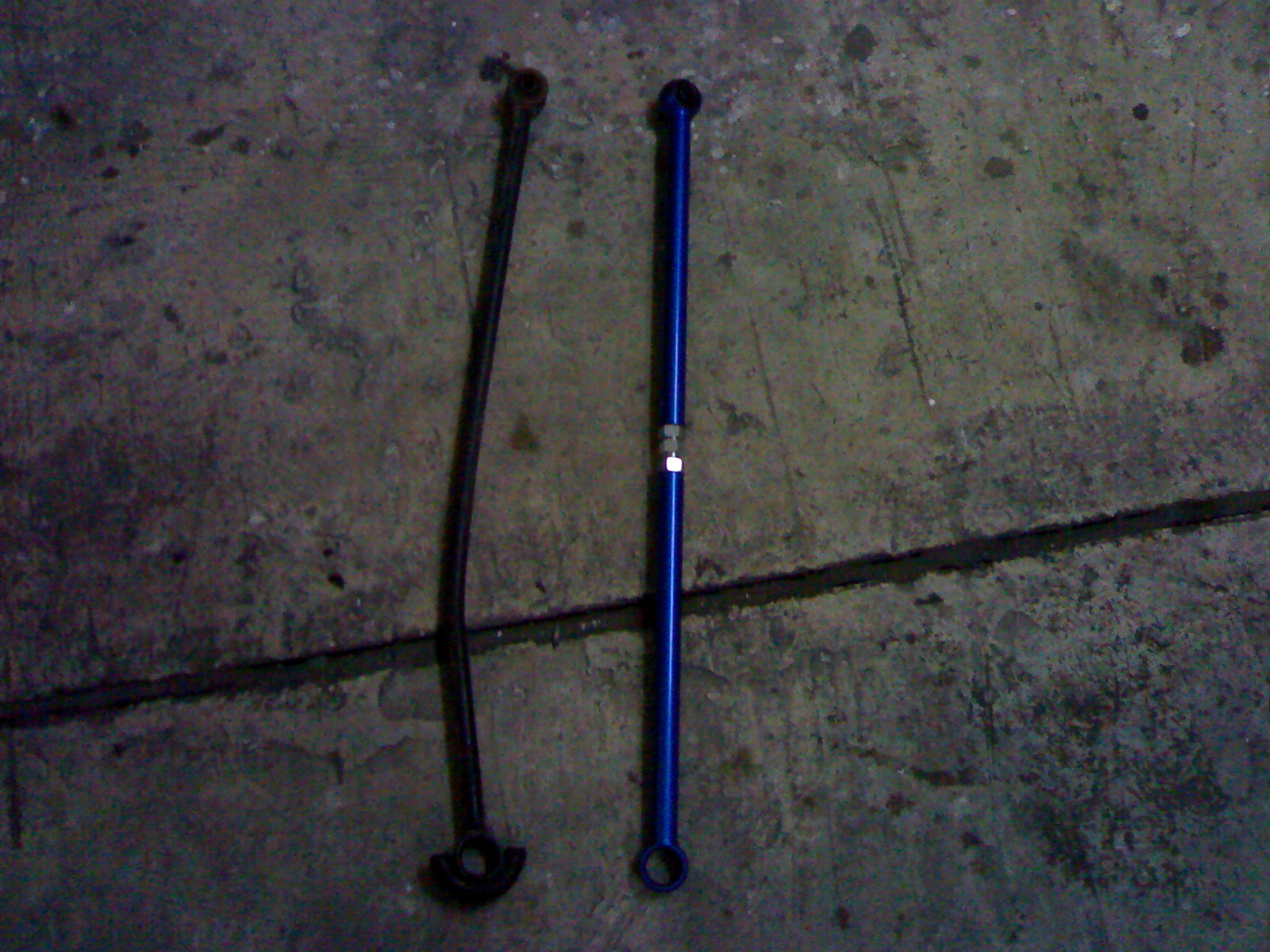

Another question - when you lower the car (even with only 40mm) isnt it necessary to adjust the panhard rod aswell?
By my understanding the car falls down, so the panhard rod is pushing more to the left and the rear axle is not anymore centered by it.
Yes you will need one of these adjustable one.
OR you could do a bit of cutting and welding...
Otherwise your diff will sit to one side of the car...
