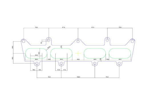

03-02-2011, 05:50 PM
4age intake side (port) dimensions
I have some previus drawing friend made when he was making adapter for bigport head.
There were no dimensions in CAD drawing so i printed it out and made it by hand... sorry Smile
And than photod by phone. sorry x2. Big Grin
[Image: AEU86 AE86 - 4age intake side (port) dimensions]
If anyone need it in DWG, just let me know your email and i'll send it
I still need smallport head sketch Smile

03-03-2011, 12:43 AM
And here adapter we made for big port:
Thanks for small port! Smile
